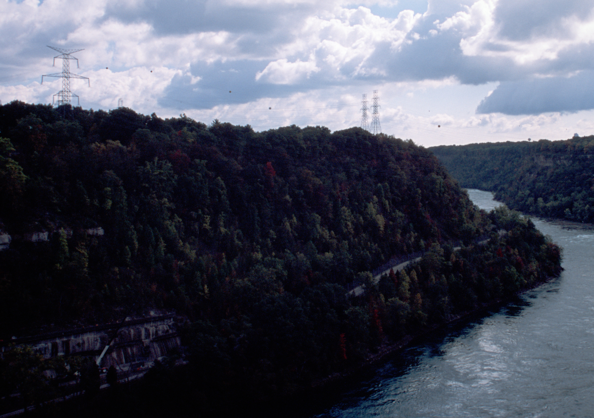

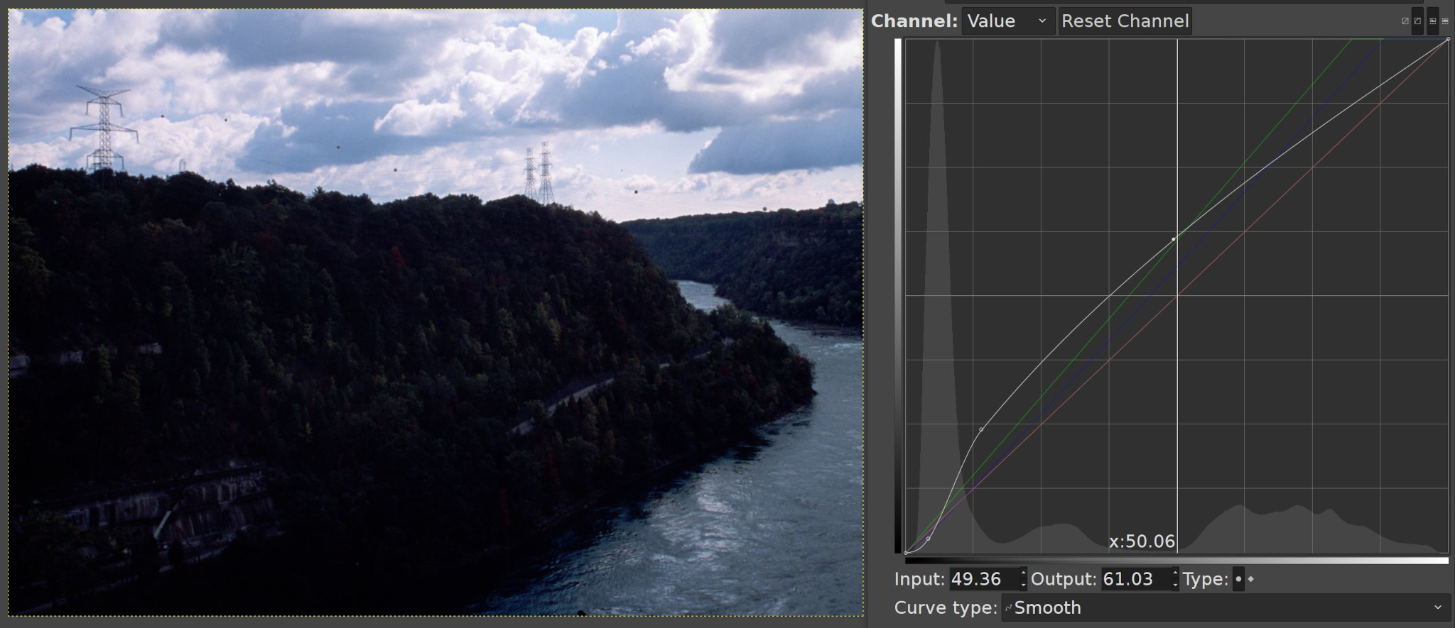

I was using Provia 100F. You can see the curve below I applied to the image. It needed to be exposed at EV15 to keep the detail in the sky, but I think the wooded areas in the scene can't be more than EV11. Viewed in-person, these woods were quite rich and colorful, not dark.
If I apply a second curve to try to pull up the shadows a little more, I can make it more like you would see with your eyes, but the gradation becomes harsh and odd looking.
If I'm out shooting slide film, are there things that can be done to improve the image from a scene like this? Or is this just something that's just going to be better on negative? Should I be carrying some kind of adjustable square neutral density filter than I can darken the sky with? Will that make the shot look unnatural? Thanks for your ideas.
A big part of your problem is that the Sun is in front of you, not directly in line with the lens, but still in front of you and the foreground is back lit. If you had taken the exposure for the vegetation only, then the sky would be slightly washed out and the rest of the exposure would be correct. For decades I have taken light readings without the sky in the field of view and I have almost never had your experience that you have. Do not take light reading with any of the sky in the field of view and you will not have this problem again, also there will be much less post processing needed.
I may have been able to add one more stop of exposure at the most, before highlights got totally blown. If I went the four+ stops the vegetation needed, the sky would have been nearly all white.
Korak's idea about the two exposures in the digitization step is interesting but my experience with the DR on this digitization camera is you can get a little more shadow detail from slide by adding an extra stop, but beyond that, you don't really get a lot more that you can pull up from the RAW compared to the normal exposure. And if there's more detail there, you can see it with your eyes pretty well with the slide in front of the light source. In this case, it was a little dark even for the human eye, so more exposure was required.

If you want a wider exposure latitude, you need to use C41 color print film.
