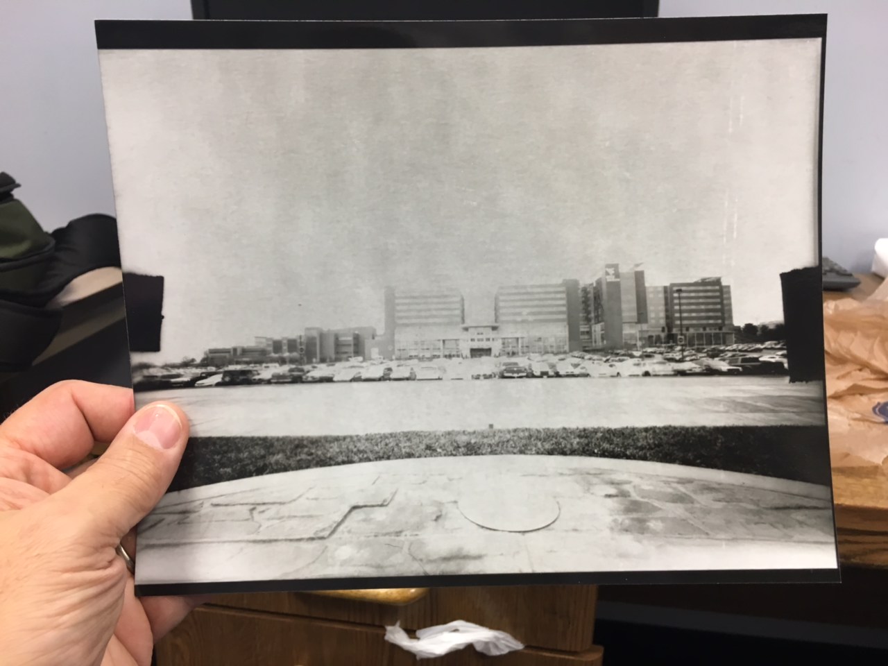

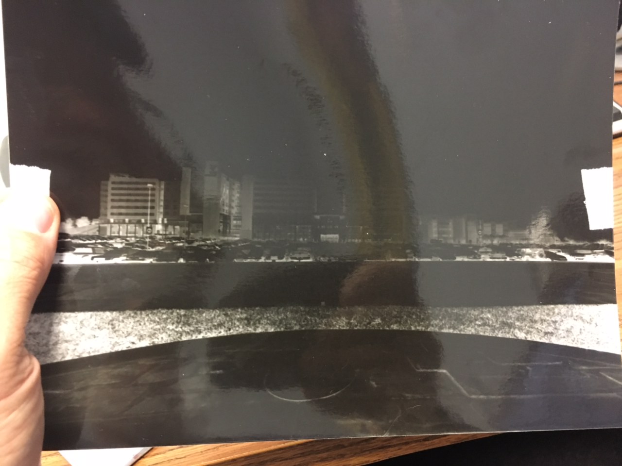

I took it out and took a shot of a local hospital. I guessed at the time, my neg came out REALLY dark. (paper negative 7 x 10)
My problem is this; why is the middle lighter than the edges and is this normal? Is the paper just too big?

You are working at a fairly wide angle, and fall-off away from the center axis is a normal thing. Not sure why, but I have felt it's more noticeable with paper than with film, which doesn't make much sense.

The edges are farther away from the pinhole than the centre is, so the paper negative receives less exposure at the edges. This is normal.

Some further comment about fall-off. Not only is the pinhole-to-film distance increasing as you move off-axis, there is also the problem that a circle viewed at an angle becomes an ellipse so the effective aperture area is shrinking. At 90º off axis, the pinhole appears closed. So there is an exponential decrease in exposure due to those combined effects.
An additional problem can be in the actual fabrication of the pinhole. The ideal pinhole has a perfectly round knife sharp edge and is made in an infinitesimally thin sheet -- a rather impractical situation! In an extreme opposite case, where a hole is drilled in a relatively thick plate, the fall-off is much more rapid and will produce a vignetted image. It's fun stuff and in the end, sort of comforting to get a recognizable image with so little technology.

I guess it looks worse by having a 10" wide piece of paper in the box, If I were only looking at a 4x5 then it would seem a LOT more uniform.
