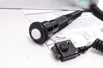

Ive got one of these for my mamiya 645PRO and RZ67PROII
Im considering buying another and I already have one of these too
Could the cables be cut and soldered to make a radio release for Mamiya?

Should be doable. You might also consider getting a Mamiya adapter for a regular mechanic release cable instead. Open up the adapter (just small screws) and solder the radio release cable onto the contacts in the adapter. The adapter is probably much cheaper than another electrical cable release. There's no electronics inside/involved. For Paul Ron, this release is only for the manual Mamiya's. The 645AF series have a different round connector. It has a half way contact for the meter in the AE prisms but that would no longer work with the proposed setup.

I took apart the Mamiya manual plunger to 645Pro/RZ adapter and all it is is a contact between two pins. So, I do actually think this might be possible if the quick momentary of the wireless trigger is long enough for the body to pick it up. If not, maybe a capacitor is needed.

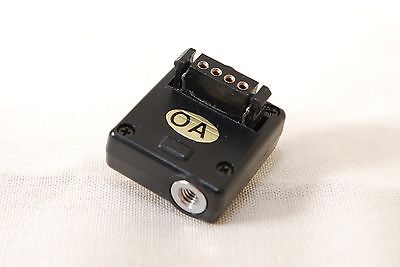

If the adapter is hard (expensive) to find, you might also go to an electronics (web)store and buy something like this. With a bit of filing and epoxy glue you might be able to connect two of the female wire sockets to the pins in the camera. A standard 4-pin female header doesn't fit, I tried that myself some time ago. To figure out which pins you need, just take a piece of wire and hold it against the various two pin combinations until the shutter trips.
Soeren
Nov 5, 2004
2,675
Naestved, DK
Mamiya Cable Release Adapter RC401
Thanks. Found it. Looks simpler and its not too expensive
Hmm make a socket so its a dual purpose adapter :wink:
