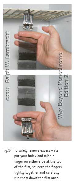

... I know that it would be better to rinse it with more volume of water but my main concern now is still temperature. My tap water is 28.5C. I feel temperature will have a more detrimental effect than volume of water. I may be wrong. I wish someone can just tell me to use 28C water and no problem. I will be happily doing that. I even thought of filling up a whole big bucket of 20C water and pouring it in slowly for 5 minutes but i think i might break my back. Thus my dilemma.
A temperature of 28C is high, but the only risk is emulsion damage from excessive swelling. If handled with care, 28C is a maximum but possible washing temperature. The warmer the water, the better the washing, by the way. I suggest to use two bath fixing (2 min each), HCA (2 min) and a standard wash of 10 minutes in slowly running water. Then, a final bath in distilled water, hang to dry and use nothing but your fingers to get rid of excess water.
