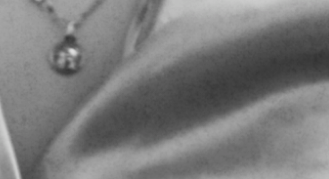

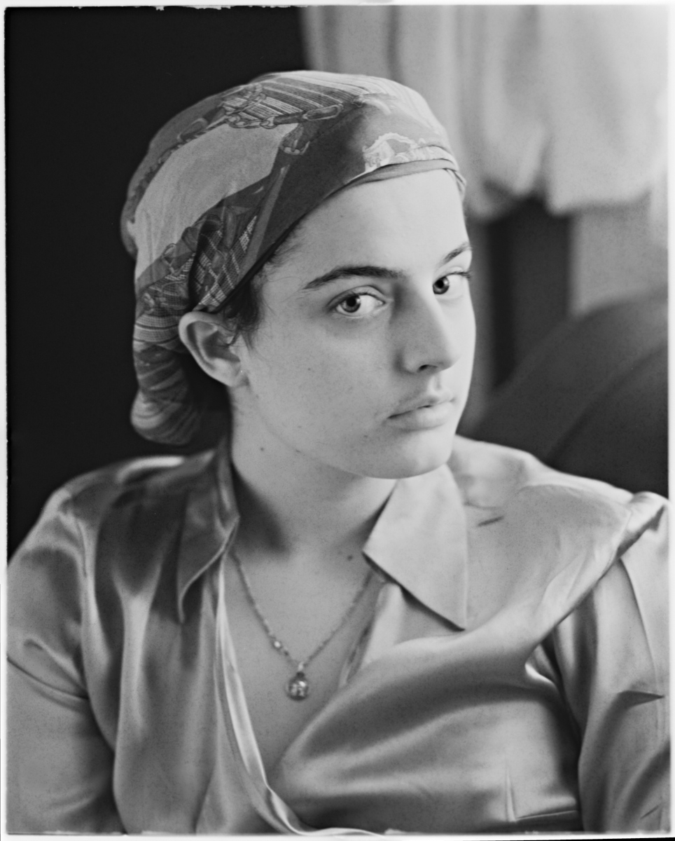

I was doing some tests with Rollei Retro 80s (120 format) and ended up with what I can best describe as "clumpy grain" in the mids and shadows, rendering a rather unpleasant image.
I developed in HC-110 (B) at a constant 74 degrees from start to finish thanks to a sous vide (yes, I know, a bit warm, but it's actually difficult to get water in my basement colder than 74 right now is Virginia, and I did reduce development time to compensate). Fresh Ilford Rapid X fixer, not so fresh HC-110 (new formula - probably coming up on nine months old); water stop bath (I've never used a chemical stop bath).
In Googling (or Photrio-ing) "reticulation" and "clumpy grain" I'm not entirely convinced either apply, but I'm not sure what else is at play here. My best guess is that it must be the development time - perhaps I under compensated for the high temperature, and the warm water over-developed those regions??? I utilized Ilford's Temperature Compensation Chart to do the math...
Any thoughts?
As displayed on my screen at this resolution, the image looks smooth to me. I don't see much grain, 'clumpy' or otherwise, nor anything I would call reticulation.
Can you describe what you are seeing that is 'unpleasant' in more detail? Or maybe we need to see what the image looks like zoomed in to a higher resolution?
That looks like digital artifacts to me.
Yes looks digital artefacts. And hc-110 is not a sharp grain / accutance developer, so it scans that way.

Here's a link with a higher-resolution file: https://halistry.smugmug.com/Black-and-White-Film/i-rhwbnR6/A however, @bnxvs 's screenshot captured the problem well...it's particularly noticeable in the curtains.
Matt - I'm open, but I would have to really scratch my head if that's the problem. I scanned it the way I scan all of my B&W -- with my camera. Same process every time, and never had this happen before.

That makes sense to me...if it was reticulation, it would effect the highlights as well.
The way I would check for this is:
1) re-scan with the negative still the same way up, but rotated 180 degrees. If the clumpy parts move, than there is a good chance that the problem is in the scanning; and
2) examine the negatives visually under high magnification. If you don't see the clumpy parts, the problem is in the scanning.
The image I see has very low acutance, which will tend to make digital artifacts more apparent.
It may be that the combination of the developer, the film, your development conditions, your DSLR optics, your DSLR firmware, your RAW converter and your post processing software are all combining to create the artifacts.
I tried both front and back of the negative, with the same results. Haven’t tried 180 yet, though.
I looked at the high resolution file at smugmug. I see the black speckles most prominently in the dark part of the lady's collar. I am perplexed by this. If you were using a scanner, I would suggest that you were sharpening while scanning. Never do that; scan unsharpened. I second the suggestion above that you rotate the negative 180 degrees and see if the black speckles change. Another observation: the details like the eyelashes look diffused. I hate to use the term "sharp" because so many of the D crowd go ballistic over the topic, but the details in this frame look a bit fuzzy. When you rescan, be extra careful about focus of your macro lens. I hope it works out.

I have used this film once or twice in the past, but immediately decided it wasn't worthwhile using it again because it had severe problems with the backing paper interacting with the emulsion, resulting in similar issues as shown here, i.e. low density 'splotches'.
Btw, the scan looks decidedly soft/unfocused. I suspect there's some room for improvement here, although it won't solve the problem you're reporting.
That's a real shame. I really like the unusual response this film has to red, and its ability to get really deep blacks. Guess I'll just switch to 35mm.
