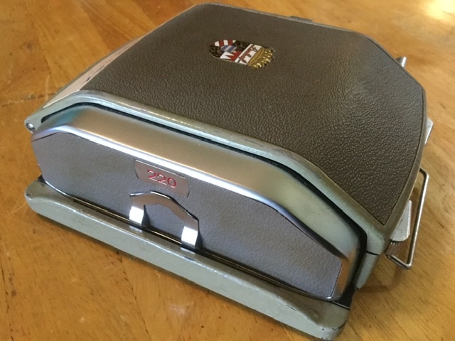

I like 220, but I don’t see it coming back. I have a stash of TXP220 purchased from the last batch and frozen, and a 6x7 220 insert for my Linhof 2x3 and 4x5 rollfilm backs, as well as a Sinar Zoom II back that can handle 220, and like a few people who have posted above, I save it for travel when I’m likely to be shooting mostly the same film at the same speed most of the time. When I run out, the 220-only insert will join the sheet film pack and all the other obsolete rollfilm formats.
I didn’t know that there was a 220 insert for Linfof. I also have a stash of 320TXP in 220.
Yes, you can probably find them cheap these days on eBay, or B&H will sell you a new one, special order no return, for $1800. I think I got it used as a 220 6x7 back, but I swap it between 6x7cm backs for the 2x3” and the 4x5” Technika systems. If you have a 4x5” 6x7cm 120 back and just want the 220 insert, you might get it cheaper from a 2x3” 6x7cm back, since it’s less popular, and the 2x3” rollfilm backs don’t fit any other system (though the inserts are interchangeable with other Linhof backs).
Good to know; if I find one at a reasonable price, I will grab it and use it on my Baby Technika.
The 220 insert is marked like this one:
