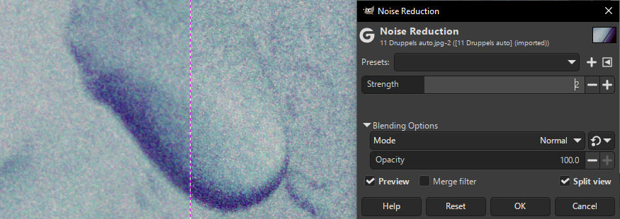

In GIMP, there's a very rudimentary noise-reduction filter:
Shown is a 100% crop of a 3200dpi scan from a Fuji NPS160 negative. Note how the grain is suppressed - and also how detail gets smeared. Filtered area shown left of the dashed line, original to the right.
As said, suites like Photoshop may have more advanced noise-reduction tools that will retail more detail/crispness while suppressing noise (scanned grain etc.) quite effectively.
Scanning software often also has similar noise/grain suppression tools, but they invariably come at the cost of fine detail as shown above. I personally never use them because I don't see the point in throwing away scanning data right from the get-go. Maybe new versions of VueScan have more effective noise reduction tools than the ones I'm used to from eons ago.
Finally, coming back to the 'scanned grain' aspect: note that it makes a lot of difference how you scan your film. E.g. on my flatbed Epson 4990 I get relatively grain-free scans - but they're also somewhat less crisp and detailed than from e.g. my film-dedicated Minolta Scan Dual IV. So if you want to optimize for low-grain, consider using a flatbed scanner.
