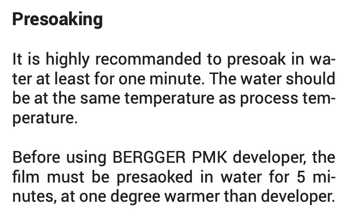

Super8
I haven't read through whatever opinions, myths and alchemy might have been posted to date, but I learned to presoak and no longer do so unless instructed by the film manufacturer, such as Bergger:

DREW WILEY
Jul 14, 2011
14,857
8x10 Format
5 minutes presoak seems a bit ridiculous. Bergger didn't invent PMK anyway. And as far as Ilford goes, I presoaked HP5 100% of the time, about 2 min, with totally consistent results in PMK.

Traditional
I use a Stearman Press 8x10 setup.
Pre-soaking is mandatory, according to Stearman Press.
Ilford recommends NO pre-soak for HP5+
Conundrum Alert! 🧐
I pre-soak.
I haven't had any issues.
YMMV.
