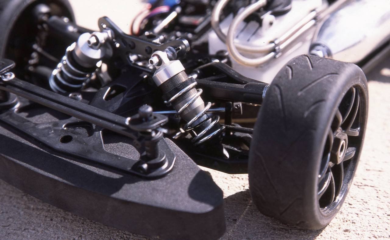

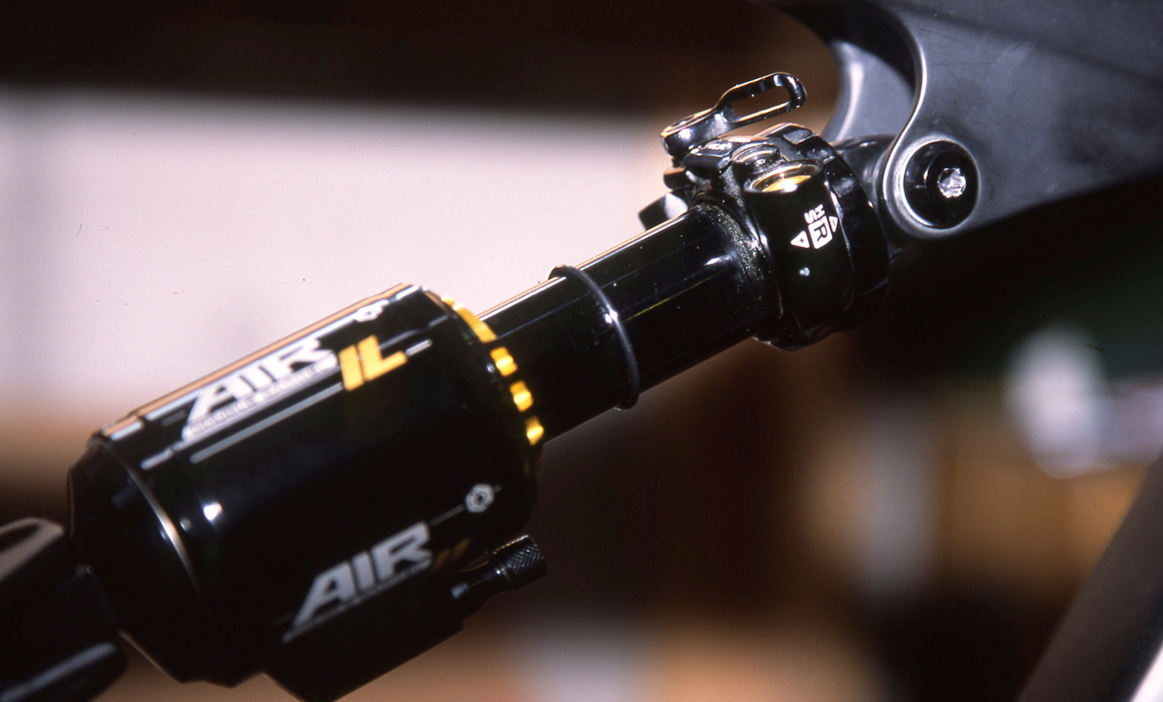

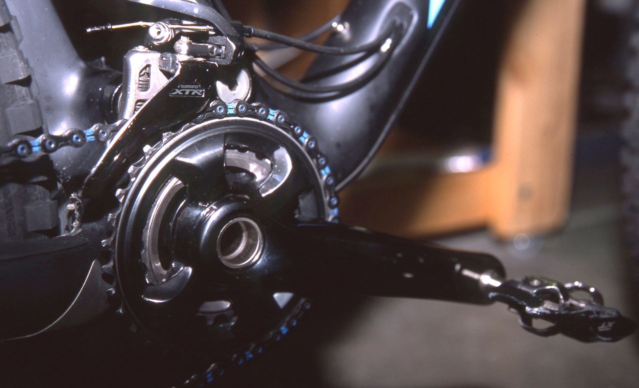

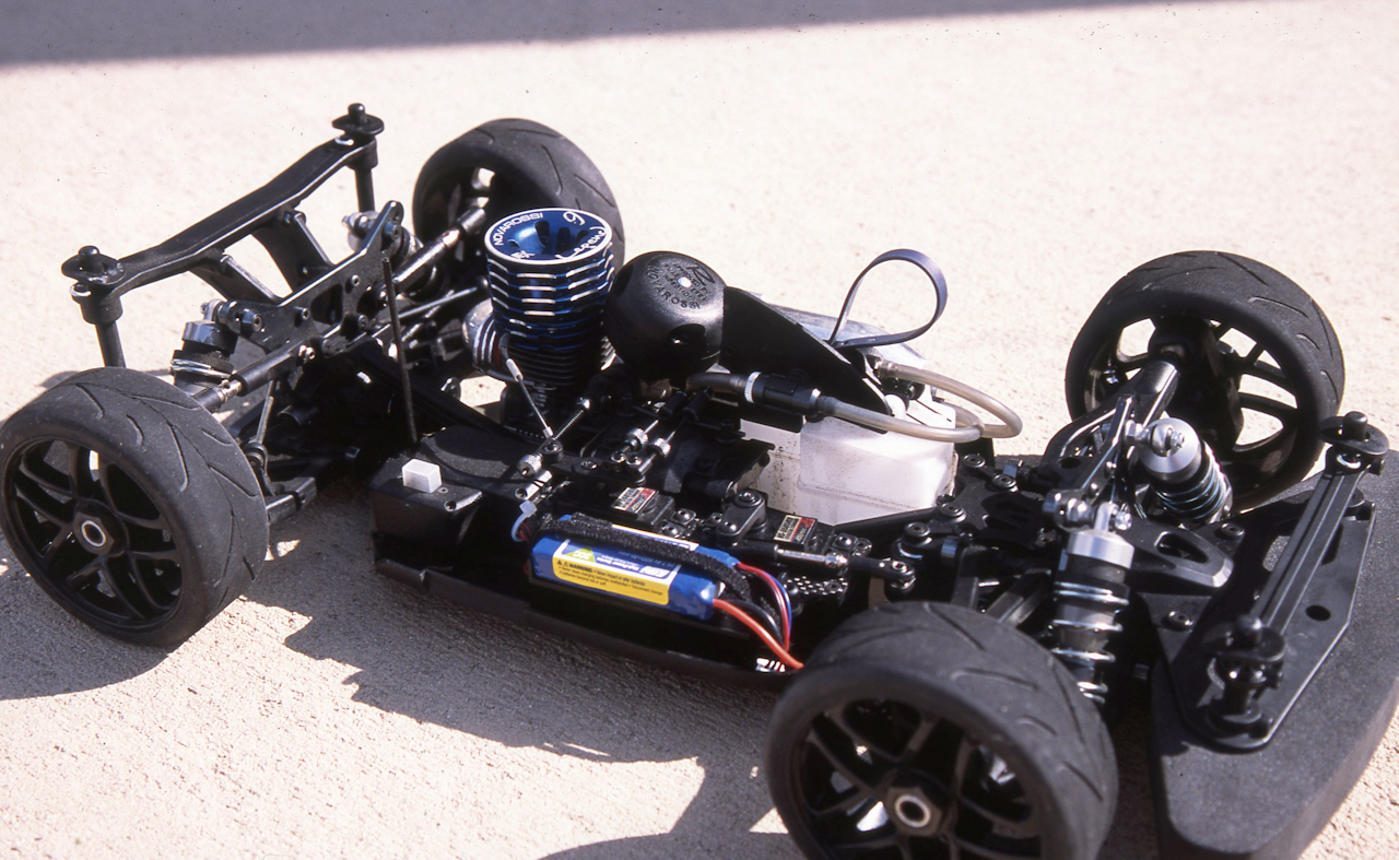

Just for grins I ran out and shot a roll of Provia 100. I just processed it and it looks fine ( waiting to finish drying ). I will scan a few and post a sample. The kicker is, I just looked and I bought the kit ( Arista 3 step ) May 2014.
Samples, dust continues to plague me.
