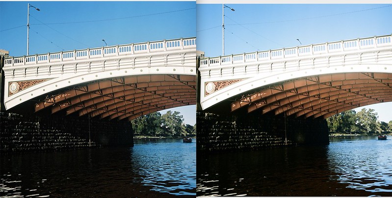

Is there a problem with my Rolleiflex? Weird blooming effect.

What kind of film? I wonder if it's halation? Does it happen with other brands of film?
abruzzi
Mar 10, 2018
3,264
New Mexico, USA
I think he said Portra 400 which shouldn't have halation effects. If it was Cinestill 800, then I'd expect it.
The other thing, to my eye the image looks very high contrast (I've never shot Portra 400, so I could be wrong.) Maybe its the scene, but I'd expect softer rendering. Maked me wonder about the scanning, or if the exposure was off and the scanning is compensating for under or over exposed film (another reason to see the actual negatives to know whether the exposure looks correct.)

I would go down the path of the lens needing a good and thorough internal cleaning. Yes you may be able to take the lens apart yourself but I personally advise against it - lenses are delicate and easily upset if you are not competently trained. It may be a good time as ever to have a full service on the camera because the 3.5A is a very old camera (made between 1951 and 1954 also called the a Rollieflex Automat) and any lubrication in the internal workings will have long outlived it's purpose. (due to it's age the lens coating will be very basic and no where up to current standards|) After a service, it will be like a new camera.

So, some new interesting things. I picked up the negatives today and although I am hardly an expert, the negative of the image I posted looks pretty good to my eye, and I can't see any of the blooming problems that bothered me about the scan.
Digging a little more, I think that the local lab I have been using has a pretty decent 35mm scanner (Fuji SP-500), but that one doesn't do 120 as far as I can tell. I am really wondering whether they are using some much lower-quality scanner for the larger negatives. Like abruzzi, I have been pretty puzzled by how contrasty the Portra shots have looked, which adds to my questions about the scanning.
I'm planning to go to another lab today which has the SP-3000, which I hear good things about. Hopefully they'll be able to scan the negatives. I'm definitely considering getting my own scanner, but hopefully this will be a start.
I still have 12 days to make up my mind about the return, but I really am starting to think the scanning may be the main problem here. Sharpness hasn't been amazing but some scans are all right. I'll keep you posted about the new scans!
EDIT: I've dropped off the negatives at the new place. They're pretty expensive, but I'm OK with that if the results are much better.

Apologies for my lack of information, and for being generally naive about vintage cameras and how to inspect them. Thank you to Kino for the suggestion about inspecting the lens; I will give that a go once I finish off the roll currently in the camera.
Set aperture wide open, hold shutter open and shine an LED flashlight from both directions through the lens and look for hazy lens surfaces. My experience dust and "some" scratches don't really have much effect. Haze on the other hand, even a light haze, will kill the performance. Most of these old lenses can be cleaned up to work fine.

Hey everyone,
So I got my scans back a while ago, sorry for the lack of updates. Definitely I think the Frontier scans look much nicer. Here's the re-scanned version of the original image:
Scanning comparison on Flickr
The Frontier is on the left, and the old scan I posted is on the right. The Frontier maybe isn't perfect but to my eyes looks much better. So I'm inclined to say that most problems here were just a result of the scanner.

I tend to agree looking at the newer version. The very bright highlights of the sides of the bridge was shall we say a bridge too far for the dynamic range of the original scanner
I agree. And you'd do even better, with an Epson, Vuescan, and a decent workflow (you'd rescue some of those shadows).

Yes, but youse still has to use the electronic image medium to get the image here so it can be evaluated and the trouble source identified. If'n youse has a problem with this then I suggest youse throw ayay all your electronic devices and go back to the cruder ways where you can stumble and fumble more.
NOW if you really want to see the difference betwen the lab scans open each in a Photo Editing Program and see how much adjustment latitude there is without having the deep shadows go black or the highlight block up into a white blob.
