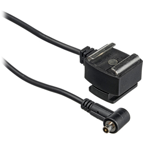

Is there a new unit that I could depend on? It has to have the X sync cord. There is no hot shoe.
Thanks.
There is a accessory hot-shoe, that got a PC-connector or a PC-cable to connect a hot-foot-only flash to a camera with cold-shoe.
Edit:
As shown above....

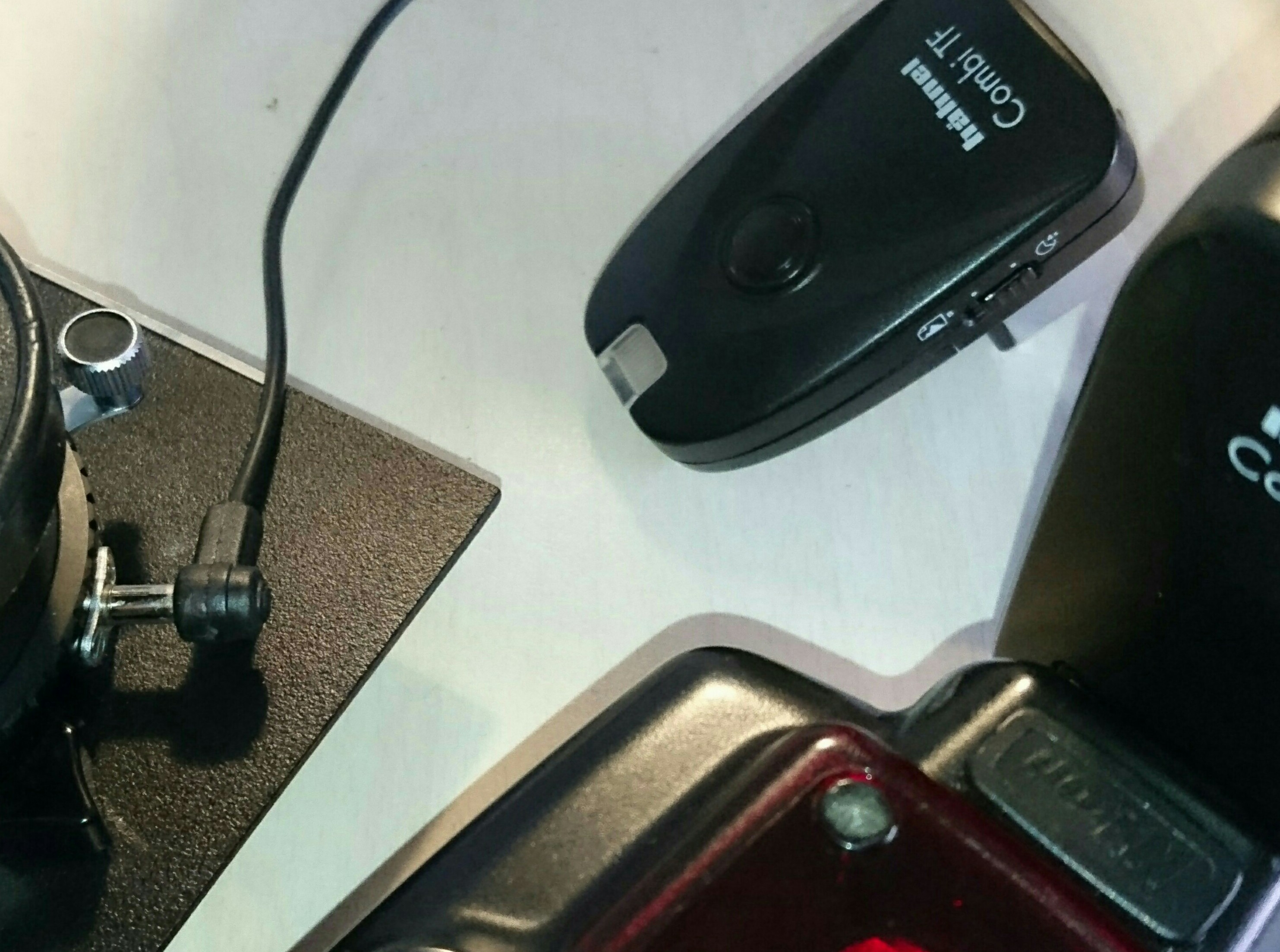

That is something I could use, the lower image of the pc to hot shoe? So, you just plug the pc end into the leaf shutter lens port?
So, I did a search on, pc to hot shoe, and found one that I bought from Sammy's Camera. Maybe it'll work with my Canon flash from the 5D. It has a hot shoe, the flash does. The cord has a hot shoe on top and a cold shoe on bottom with a wire to a pc plug. That will sit on the cold shoe on the wooden handle connected to the Pentax 6x7 camera and plug into the 90mm leaf shutter lens. The Canon flash will go onto the hot shoe.

Yes plugged in the pc port
