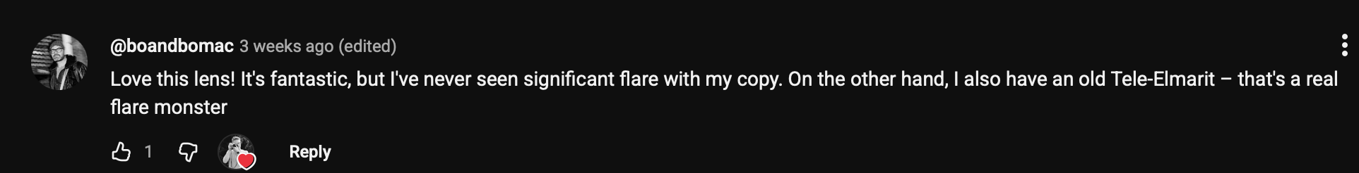

Someone in the comments made the following claim:
