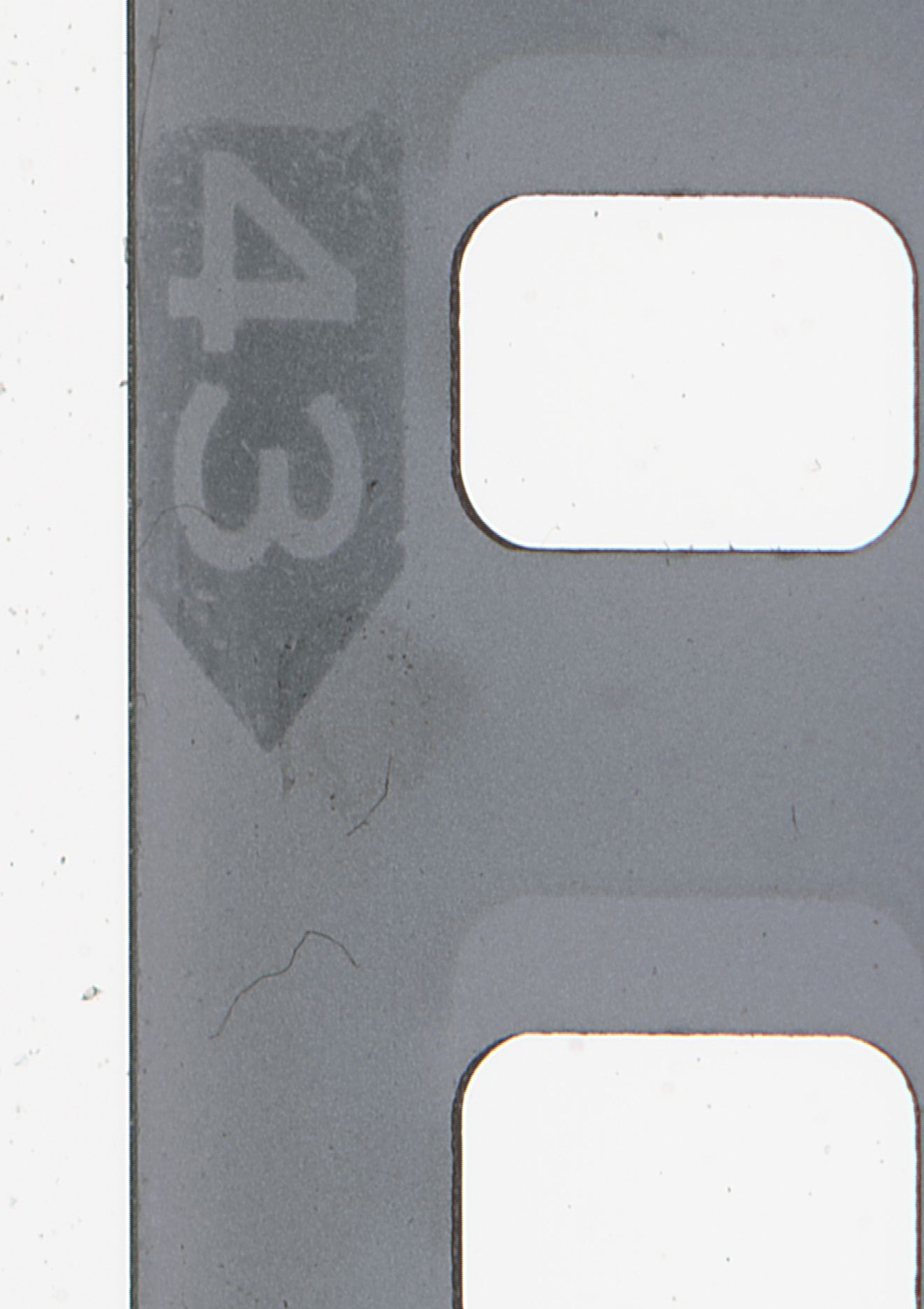

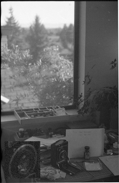

I bought a bulk film loader that came with a roll of film in it. The loader has instructions from 1956, and its box looks like it has sat forgotten in a cupboard for 70 years. Seems about iso 50 now, but I bet it was about 100 or 125 when it was new. seems fine-ish grain. 8 mins in hc110B, 6 mins was too little. The edge signing has _only_ numbers in little black arrow signs. It could of course be newish film. Of course someone had opened it in light, but after discarding a 4 ft, just the edges are fogged so no 'light piping'
Anyone know what it is?
Anyone know of an edge signing database?

As I recall, Tech Pan was a funny one. In 35mm I've seen TP and on others there was nothing. I recall Kodak saying this was normal.
The number 43 is typographically definitely from a Kodak film, I can't tell anything more
I don't know if there is enough information in the OP to identify.
Figures within an arrow seem special to me.
Yes Otto, the typography is special too.
This might by from same font:
I recall that the frame numbers were like that on Kodak USA bulk rolls in the 1960 era. the opposite edge generally had alternating "Kodak S'afety film and "Kodak (type) film.

some things are common, the arrow on Kodak film by the frame number indicating which side was the emulsion side. The tendency for European film to use a Number from 0 up to 88 every 4 perforations, compared to 00 to 37 every 8 perforations for packed 35mm, and 44 down to 1 for Kodak Bulk film.
Thanks all who replied. After the Kodak typography and Panatomic X suggestions, I went back and looked again and discovered "KODAK SAFETY FILM" and "KODAK TRI X PAN" peeking out the fog of a fogged edge. So that answers that.
