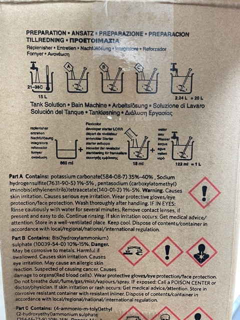

So I had purchased the Kodak Flexicolor Developer and Replenisher kit (20L) from uniquephoto and am wondering if I need this starter when mixing the chemicals or if this is even the correct starter for this kit? What does LORR mean? Or LORR Flexicolor LU.
I'm talking about these 3 products.
Thanks!

@reelquickfilmlab here's what you need to mix to make a 1L of working solution for your JOBO:
YES! THIS IS CORRECT. KODAK SINOPROMISE DOESN'T MAKE A DEVELOPER,... ONLY A REPLENISHER AND A STARTER. MAKE UP THE 20 L of REPLENISHER AND STORE IN ABSOLUTELY FULL 2 L BOTTLES. DILUTE THE REPLENISHER AND ADD STARTER AS NEEDED. THE REPLENISHER WILL KEEP FOR WEEKS, MIXED, IN ABSOLUTELY FULL PET OR GLASS BOTTLES.
STARTER IS REQUIRED FOR RA4 DEVELOPER AS WELL. UNLIKE FUJI, KODAK DOESN'T MAKE YOU BUY 1 GALLON BOTTLES OF STARTER.
NO ONE HERE IS AN IDIOT, THIS INFORMATION IS HARD TO UNCOVER.
