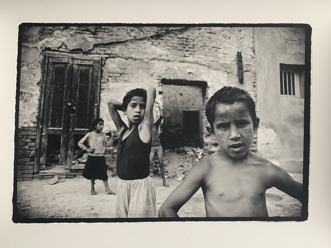

Iphone shot of a print, tmax 100.
Everything that can be said is said in this simple shot:
-not muddy
-correct focus
-correct composition
-iso 100
-acceptable depth of field
-acceptable print

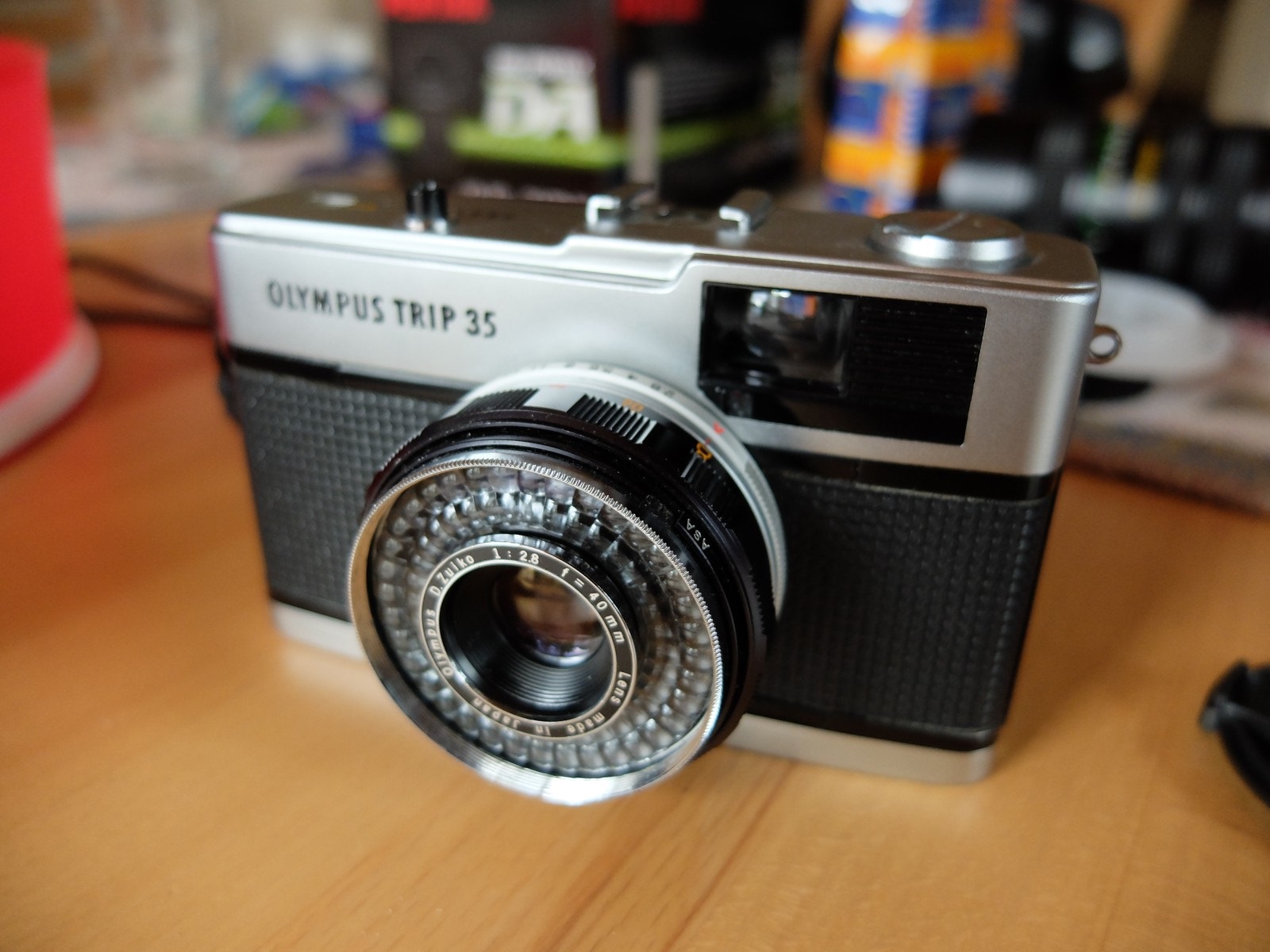

The king of zone focusing.
