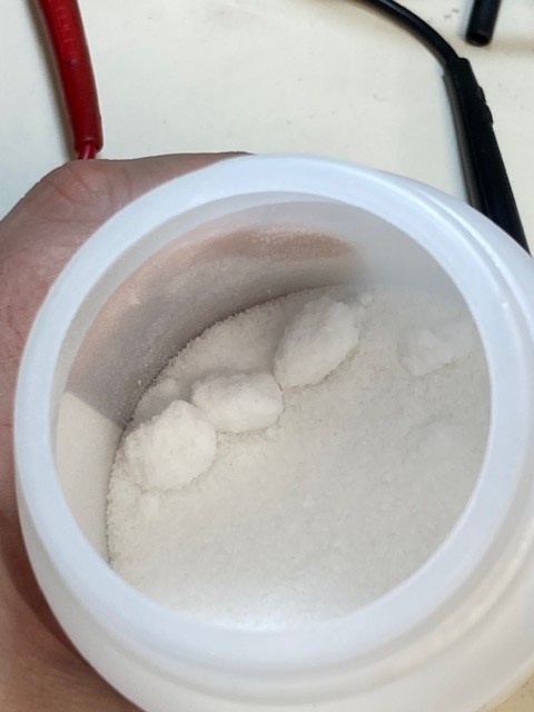

I received my chemicals from Artcraft. The metol and the sodium metaborate came in a dark container while the sulfite came in a white one. All containers were wrapped with black tape? Is it normal for the metaborate to be clumpy? The other two containers don't make any sharp sounds when shaking them.

Lots of chemicals are "clumpy" -- depending on what that means. My Kodalk is not anywhere as fine as salt or sugar -- if that's what you mean.

I brought the container to the light and can see the inside better. I can see a combination of fine and rocky looking clumps in the container. The clumps do not appear to fall apart while shaking the container.

Do they fall apart when you press them with your finger? If yes, then fuhgeddaboudit.

My experience after 3 years is that so long as it is kept in a sealed container it may become clumpy but its property is unchanged.

"Clump" is still undefined, as is "Stale". If Metol (and Kodalk) are kept in sealed containers they should last a LONG time. I was given a five POUND bottle of Metol 25 years ago, and it's still works fine. There's a reason they don't have an expiration date. Clumpy? Some might think so --- depending on how big or small, hard or soft, a "clump" is. Brown? Some might say so. I'd say more "egg shell".

Sodium Metaborate is actually crystals of varying water content. This suggests that it is not very demanding to store. The lumps may have formed during the crystallization process. And my metaborate, which I got from Suvatlar (Germany), is lumpy.

Sodium metaborate is hygroscopic so it absorbs water from the environment over time, which tends to stick the crystals together and so there can sometimes be some big chunks of the chemical in purchased jars of it. Sometimes I get a new jar from ArtCraft and it has no lumps in it, and sometimes there are. Over time, I find it develops large, hard lumps by itself. To be usable, you may have to remove the big chunks and - putting them in a (clean) heavy plastic bag - smash them up with a hammer.

Yea, it's a little lumpy sometimes. Fairly fresh, it should break apart without too much effort (no hammers), but the clumps get harder with age, and hammers may be required. Not as bad a potassium bromide.
Lots of chemicals absorb atmospheric water, even if the storage container is very good, as fresh air enters each time it's opened. Sodium carbonate is probably the best known to photographers. I discovered that my potassium carbonate, which hasn't changed its "powderyness" has to be used at 1.26 times the formula weight, despite being in quite good storage container with tight fitting lid.
