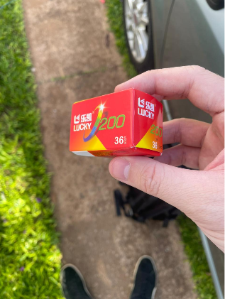

Hello everyone,
I have a question about exposure and would really appreciate the opinion of more experienced film photographers.
I’m currently shooting a roll of Lucky 200C (ISO 200 color negative, C-41) in a Yashica FX-3 Super 2000. The camera has a simple TTL light meter with LED indicators in the viewfinder: one LED for underexposure, a green LED for correct exposure, and one LED for overexposure. There is no half-stop indication in the viewfinder, only these three references.
I’ve been studying film exposure and learned that color negative film generally tolerates overexposure better than underexposure, especially when it comes to protecting shadows and achieving pleasant skin tones. Because of that, I’m considering setting the camera to ISO 160 instead of 200, which would effectively give me about +½ stop of exposure.
My question is:
Does it make sense to shoot the entire roll at ISO 160 (roughly +½ stop overexposed) and then develop it normally as ISO 200, without requesting push or pull processing?
My goals are:
  • Better shadow detail
  • Avoid slightly underexposed frames
  • More pleasing skin tones in portraits
  • Balanced contrast overall
I’m also unsure when it might be better to keep the film rated at ISO 200 instead — for example, in very harsh midday sunlight or extremely bright scenes.
Would you recommend rating this film at 160 as a general approach? Or is it better to shoot at box speed (ISO 200) and compensate only in specific lighting situations?
I would really appreciate more technical insight on how you would rate this film and how you would handle exposure using a simple LED-based meter like the one in the FX-3.
Thanks in advance.
