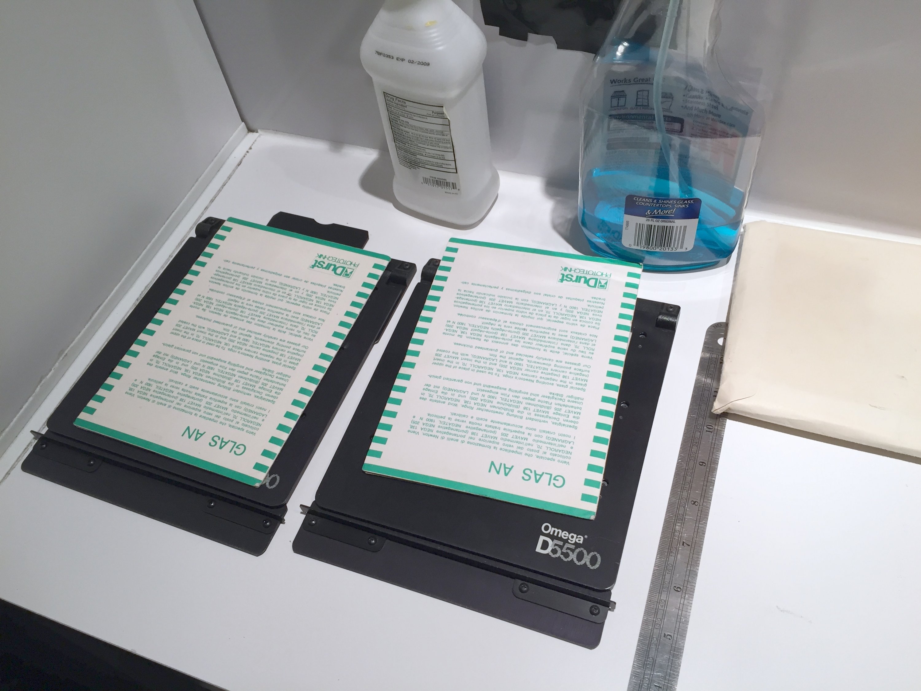

DId they stop making AN glass? I have 3 new-to me glass carriers that I was planning on adding new AN glass and did not anticipate and issues with the supply of glass.

Available off the shelf in 6x6 (nominal). No idea on the price though
