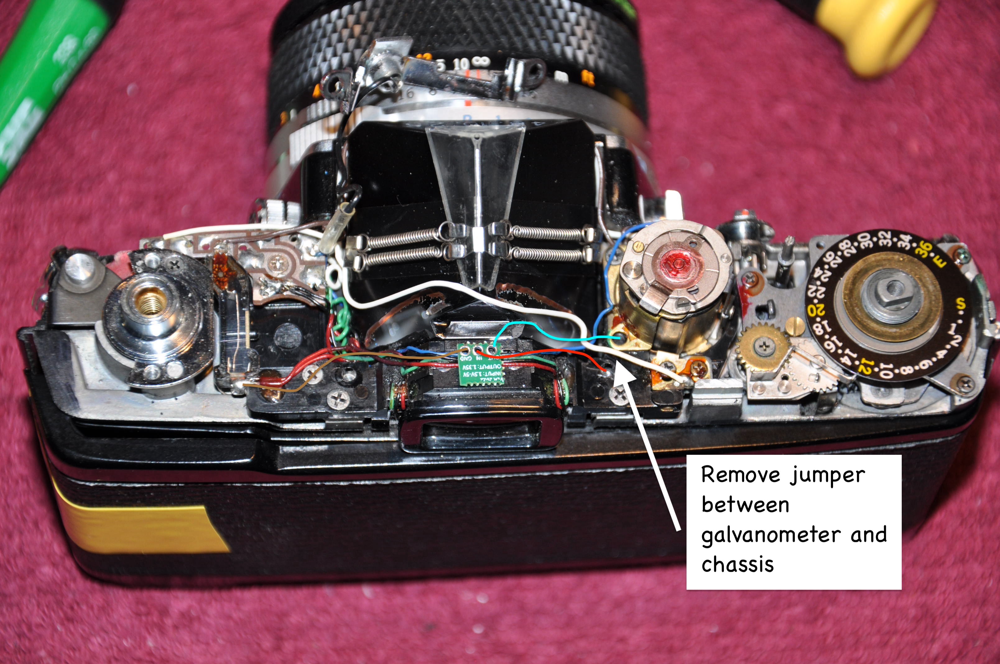

The voltage regulator (above) requires a camera with a negative ground. Maybe someone can re-configure one for a positive ground camera like the OM-1. Of course one could try to place the regulator between the battery and the cap or incorporate it into the cap somehow.
I was doing some routine maitinance on my OM-1 and thinking about my post above from a while back. I re-examined the wiring of the camera and indeed it would be possible to install the voltage regulator. I drew up a layout below.
The galvanometer receives the positive charge from the battery through a jumper to the chassis (+). The voltage regulator can be placed between the galvanometer and the chassis by removing the jumper.
The ground connection for the voltage regulator can go to the on-off switch where the red wires connect.
Brown wire: from voltage regulator ground to on-off switch, (-) from battery.
Light Blue wire: from the voltage regulator output to the galvanometer.
Red wire: from the voltage regulator input to the chassis (+).
There is just enough room under the hot shoe connector, right over the viewfinder, for the voltage regulator device.
Wow! You implemented Filip Dee’s 1.35v regulator in OM-1!!!!
