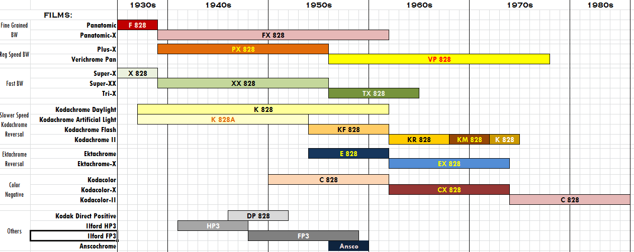

For anyone interested in the history of 828 film, I have been working through a timeline of film availability in the format based on observations over the past few years. I have some revisions still to adjust, such as the ending of Verichrome Pan in 1974, and the break out of K828 as "Kodachrome" of K-12 development type, but it's a fairly good snapshot.
As has been referenced above, Plus-X (which I should denote as "PAN") was the mid-speed BW emulsion rather than Verichrome, until 1956, when VP was released, and PX became a 35mm only film for quite some time.
While some of the technical details of 35mm and 828 are quite similar, what is interesting is that the product lines between the two formats had enough distinction to where calling 828 "35mm with a single perforation per frame" is over-simplifying to a good degree, some distinctions of which are detailed below.
Kodachrome appears to have debuted in 828 up to year earlier than 35mm, debuting in 1937.
Verichrome Pan was the 828 mid-speed film after 1956 whereas Plus-X Pan was the 35mm equivalent.
The original Kodacolor film appears to have debuted in 1950 in 828, about 8 years before it finally entered the market in 35mm.
