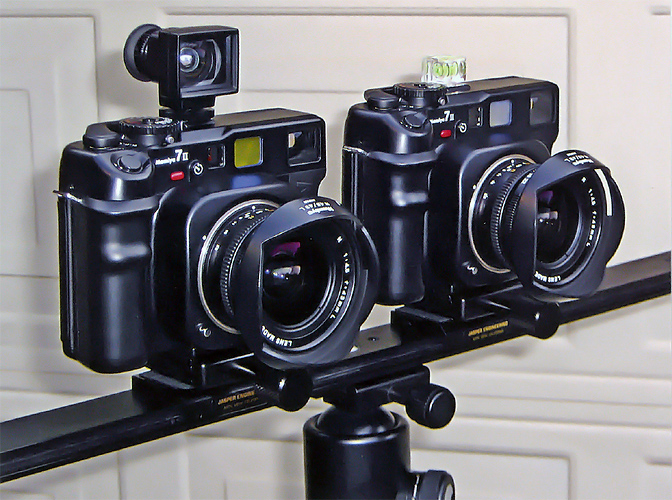

I've gone through as much as 54 rolls of 120 in two days of dusk-to-dawn shooting (at Arches NP). It can get expensive, but I didn't break down and buy my first digital camera until a year ago - a Sony a6000 with 10-18mm f/4 zoom. It's a fun toy. ;-)
I use two laser rangefinders to measure the distances from my cameras to the nearest and farthest subjects in the scene, then use a programmable HP 48G+ scientific calculator to obtain the ideal focus distance and minimum required f-Number to secure the equivalent of 8 lp/mm for a 25cm viewing distance - which is basically right at the limit of acuity for healthy human vision. If nothing in the scene resides at the calculated focus distance (except air), I use the laser rangefinder to search for a target that's at that distance, even if it's behind me, swing the cameras onto it, focus, then bring the cameras back to restore the original composition.
I sometimes stop down below the calculated minimum f-Number required to secure my required on-film CoC diameters, but as a rule, the resolution requirement I impose is so restrictive, I often find myself backing away from the nearest subject and recalculating - sometimes going up, instead of back if that's possible - (almost) never compromising my resolution goal of securing 8 lp/mm worth of real subject detail in the virtual image.
The HP48G+ is also used to calculate the proper separation (stereo base) between my camera lenses to achieve what is known as constant deviation stereography (where the amount of depth experienced in each scene is held at about 70% of the maximum acceptable deviation - that which is just short of forcing the eyes to diverge - an uncomfortable feat for most people. So, I am effectively doing reverse planimetry, by taking measurements of the subject space and adjusting the lens separation of my cameras to create the desired geometry in the stereo viewer. Hint: Less is more, when it comes to stereography. In my opinion, your audience should be able to immediately forget that they are looking at a 3D image (instead of being assaulted by it, as is so often the case in 3D motion pictures - don't get me started.) We don't walk around in this world saying, "Wow! I can see in 3D! This is so cool!" I actually strive to prevent that from happening in my stereography, as well. I'm going for the most natural, realistic experience possible.
I've also got a Minolta Booster II, which increases the sensitivity of my Sekonic L-608 by 8 stops. I've used it in Carlsbad Caverns, to shoot exposures as long as 44 minutes, with Ilford Delta 100, pulled to an ISO rating of 12 (not pushed, but pulled), to reduce the contrast of the extremely dim but very harsh lighting inside the caves. Pulling Delta 100 reduces the grain size, too! ;-) I used empirical data for Delta 100 reciprocity failure that was gathered and published by Howard Bond, the view camera guy who has done some really beautiful low-light work in the Everglades and elsewhere. I plotted all of his data in an Excel spreadsheet, then applied a polynomial trendline to extract a trustworthy equation for Delta 100 reciprocity failure. (Note: I've never corresponded with Howard Bond. He doesn't know me.)
I programmed the Excel trendline equation into my HP48G+ so that I could accurately translate meter readings taken with my Minolta Booster II-equipped Sekonic L-608 into much, much longer exposures that accurately compensate reciprocity failure for Delta 100. (Bracketing is next to impossible with 44-minute exposures, but I did so with a couple of scenes, going 1/2 over and 1/2 under.) I sent the exposed Delta 100 rolls to dr-5 for reversal processing, as I need positives in my stereo viewer, not negatives. You can see cave ceilings 100 feet or more overhead that are completely obscured in darkness when standing there in person, yet the brightly lit foreground elements, each typically lit at ground level by a single, hooded, 40W bulb, are not in the least bit overexposed. It almost looks as if I hid soft boxes throughout the entire cave. And it's all in 3D, at a resolution that pushes the limits of human acuity! ;-)
The use of medium format chromes, in combination with a relatively low enlargement factor of 4x means that not only is film grain pretty much invisible in open skies, even when Provia is pushed to ISO 200, it also means that my desired resolution of 8 lp/mm for a 25cm virtual image distance is not compromised by diffraction, even when stopping down as far as my lenses will go: f/22.6. The result is corner-to-corner plasticity - no evidence of defocus or diffraction, with the entire scene being devoid of any evidence of the usual indicators that say, "I'm looking at a photograph." It helps that I am masking out a 50x50cm crop from the original 6x7cm chromes - so you don't even have an opportunity to see into the corners of the original frames. When you look into the viewer, you really do feel as if you are THERE. In fact, many people who quickly buy into the reality of it, later comment that the total absence of movement is the only tip-off that it's not real. Digital VR cannot compete.
