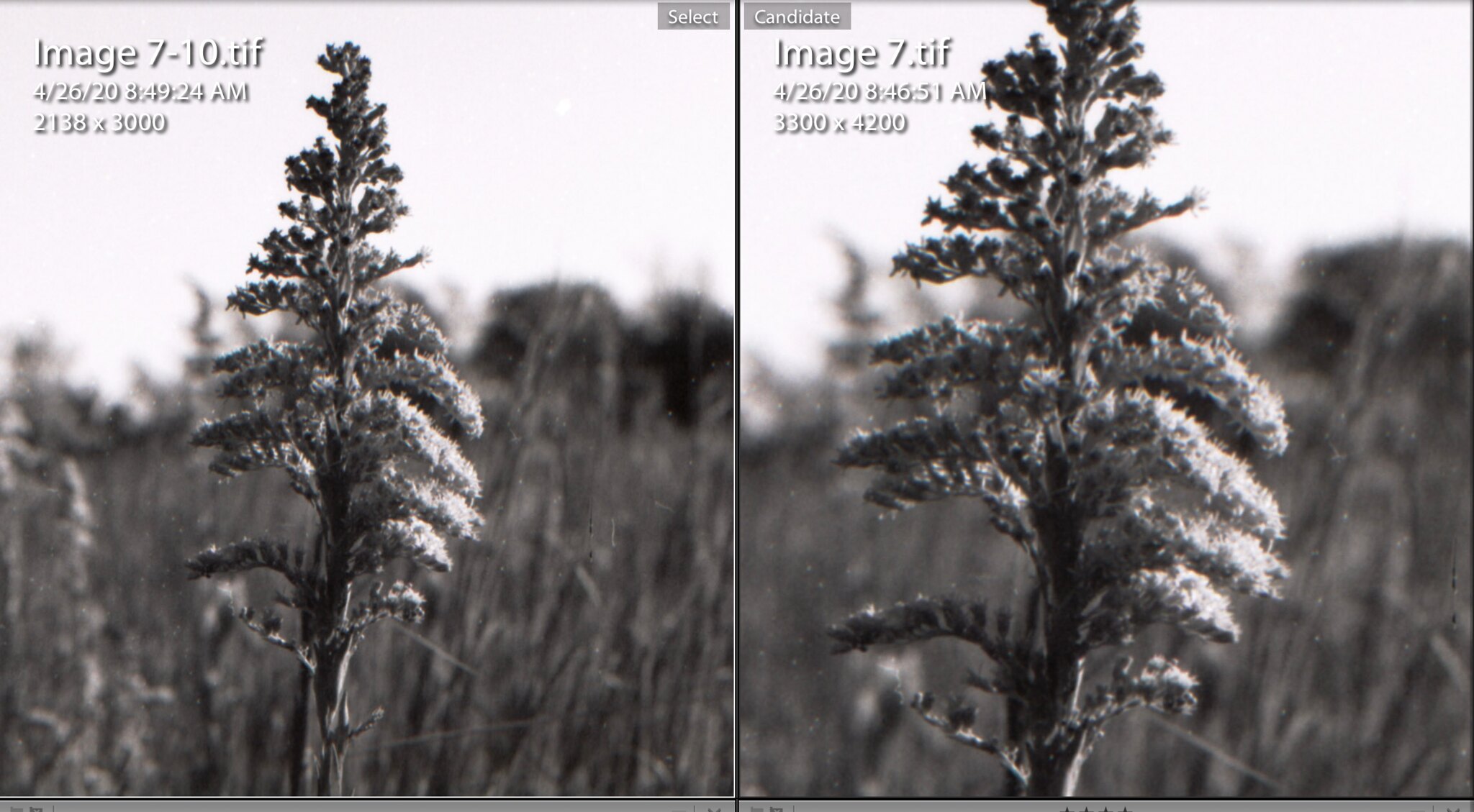

The one thing that I did notice between the trial of Silverfast, and the Epson software was that there seems to be a lot more controls with the Silverfast. Not just picture controls (i.e. shadows, highlights etc) but actual physicals like framing etc. Not sure how those controls translate into a workflow though.
I also liked the fact that Silverfast allowed you to enter the output dimensions in inches, and then showed you where that fell on the PPI scale. I did a test just to see. The one on the left is scanned at 10" on the long side, and the one the right is scanned as a 14" on the long side. It was definitely a learning experience. This is a 1:1 comparison.
Screen Shot 2020-04-26 at 8.52.34 AM by Christopher Coy, on Flickr
