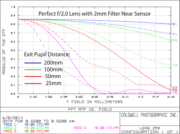

Where this will matter:
- Non-retrofocus wide angle lenses exchanged between RF and mirrorless cameras. It's possible that a wide angle designed for digital sensors would have a greater telecentricity (see below) in which case it might do ok on a film camera.
Where it won't matter:
- Retrofocus SLR/DSLR wide angle lenses (these have an exit pupil that is moved forward, by their reverse-telephoto optical design, necessary to clear the mirror). Especially if one stops down to, I don't know, maybe f/5.6.
- Normal and telephoto lenses - the exit pupil is far away from the sensor or film, so non-telecentric effects are small and the converging beam is a relatively narrow angle when it hits the glass and sensor, or film.
The exit pupil is the image of the aperture stop formed by the elements behind the aperture. To get a rough idea of where it is, take the lens off the camera and look through it from behind. It helps if you can stop down a little. Now hold the lens at some point along the barrel and rotate it side-to-side (yaw). When you are rotating it about the location of the exit pupil, the image of the aperture will stay in the same place as you rotate it. When you're holding it in front of or behind the exit pupil, the image of the aperture will move side-to-side. This is easier to do than to describe.
On telecentricity: A perfectly telecentric lens has converging beams to the sensor that are parallel to the optical axis, even for off-axis parts of the sensor. Of course, lenses are not going to be perfectly telecentric. Film isn't strongly dependent on the angle that light strikes it, but digital sensors can be, plus they have a cover glass, Bayer filter, etc in front of the actual sensor.
When the non-telecentric converging beam passes through some thickness of glass at an angle, it will introduce aberrations, most strongly astigmatism, I think. (The glass also causes a focus shift even at the center of the field, but the manufacturers presumably locate the sensor+glass to zero out this focus shift.) There can also be chromatic effects, and the combination of these effects and the Bayer filter is probably one reason for the "purple fringing" on digital cameras even with digital-intended lenses, although that seems to be more of a complaint with compacts.
Finally, my guess, just a guess, is that this problem is worse putting an old WA lens on a digital sensor, and not as bad putting a new WA lens on a film body. Because the designers of the new WA lens would have to design the new lens to either (1) introduce astigmatism that would be canceled out at the corners by the glass filter even for cameras with possibly different glass thicknesses; (2) or design it with greater telecentricity; and it seems like the second choice would be superior. Choice 2 would not affect film badly.

Thanks for your post! I learned a lot.
I'm trying to reconcile your comments with the Roger Cicala article I posted. Clearly empirically you are right (cf. the 85mm MTF links I posted), but I'm not really sure why.
All of the Nikon lenses in the article I posted have exit pupil distances between 50mm and 100mm. The 85mm 1.4 AF-S G has an 89mm distance. Let's round up and say 100 is a good estimate for 85mm lenses. Now, consider the following chart in the context of the 85 AF-D versus the 85 AF-S G.
Look at the green line. It sure seems, according to Caldwell's model, that at the corners a 2mm sensor stack difference should noticeably decrease the MTF at 40 cycles/mm for lenses with that exit pupil distance at f/2. So I would think that, compared on a digital camera, the AF-D (not designed to accommodate the stack) would suffer greatly compared to the AF-S. Yet in the OpticalLimits testing, the resolution of the lenses was exactly the same in the extreme corners and borders of the image at f/1.8.
Clearly there is something I am misunderstanding about the physics of the situation. What am I missing? (I suppose the formula for MTF is not multiplicative...)
First, we should remember Lens Rule #1: The suitability of a lens is dependent on the pictures one wants to make with it, more so than any quantitative measures such as resolving power, angle of coverage, etc.
So for example, a fast telephoto is often used near wide-open for portraits, because the perspective is flattering and the out-of-focus blur isolates subject from background. Given the intended use and shallow DOF, the resolution in the corners may not matter to the final image, and the corners will often be out of focus anyway. The story is different if one is trying to make wide-angle highly detailed corner to corner scenics (but then, stopping down and using a tripod or some sort of camera support are your friends anyway).
If all assumptions are met, MTF should be multiplicative (part of the reason why it is called a transfer function). So for example if you had a lens with an aerial image MTF of 0.5 at 50 cycles/mm, and film with MTF = 0.8 at 50 cycles/mm, and the film was perfectly flat, the total realized MTF should be 0.5*0.8=0.4. In practice I think it doesn't always quite work out that precisely, because the film doesn't behave the way the MTF-measuring optics do, and so on.
I am not an optical designer nor do I run Zemax, but I do know some optics and work with people who do. The plot that Brian Caldwell posted is output from Zemax (an industry-standard optical modeling program). I think what he did was assume an ideal f/2 conical beam incident on the 2mm glass filter, and calculate the MTF of the image aberrated after it passes through the filter at the appropriate field angle. First, note that all of the lines reach about 0.86 on-axis, not 1.0, so even the on-axis beam is theoretically affected; I think this is because the plate introduces spherical aberration. This and all the other aberrations are a strong function of f-number; it would be interesting to see the same plot for f/4.
Next, note that there are two green lines for the 100mm exit pupil, labeled S2 and T2. He didn't explain this, but these are sagittal and tangential MTF. Sagittal means along the radius from center to edge of field, but somewhat confusingly, AFAIK sagittal MTF means MTF measured using a sagittal line pattern, so it's actually image quality in the tangential direction, and tangential MTF is image quality in the radial direction. (This is super confusing and a good reliable web source on it is http://dougkerr.net/Pumpkin/articles/Astigmatism.pdf , which I recommend if you want to understand astigmatism. Many photo blogs explain this badly.)
The green S2 and T2 curves differ, a lot. S2 is better, meaning the images resolve more sagittal (radial) line pairs, ie a point source would be imaged as an ellipse along the radial direction. (Confusing.) Anyway, that's the normal direction of astigmatism - maybe also some coma. It makes some sense because if you imagine the f/2 cone of rays striking the filter at an angle, within the cone, the different rays along the radial direction have more spread in incident angle than the rays along the tangential direction. The actual image quality is going to be the imperfect image produced by the lens, multiplied by the idealized MTF of this filter, and by the MTF of the sensor. Because the lens and sensor are not ideal, this gives some sense of the reduction in resolution, but it isn't a hard and fast guide.
Regarding the on-sensor measured resolution from the opticallimits.com tests of the 85mm AF-D and AF-S G, they come up with numbers of about MTF50 at 3200 LW/PH (line width per picture height) at field edge. Picture height is 24mm and there are 2 lines/cycle, so that's 67 cycles/mm and the MTF is 0.5. Meanwhile, from Caldwell's Zemax plot, the average of sagittal and tangential MTF at 40 cycles/mm is just below 0.5, and that's without including the lens and sensor, so the real MTF would be lower, and lower still at 67 cycles//mm.
What's going on? Well after many years of different people trying to run lens tests with different methodologies, my feeling about comparing experiments to theory and one experimental number to the other is: Don't get bent out of shape about it. Remember Rule #1. It's more difficult to compare numbers absolutely across different test methods than it seems. Generally, relative measurements within the same method should be easier - rank order in the same on-sensor test likely means something, but if lens A measures 50 cycles/mm in one test and lens B measures 65 cycles/mm in some other test, I don't think it's worth trying to draw conclusions.
You can poke through other test methodologies, like for example if you go to imaging-resource.com and compare the 50/1.4 AF-D film-era lens to the 50/1.4 AF-S G, from https://www.imaging-resource.com/lenses/nikon/reviews/ , click on the full frame measures of their "blur number," which is likely derived from MTF somehow, and there really isn't much difference between the lenses. And the two versions of 50/1.8 have a difference wide open but it's gone by f/2.8.
A lot of dialogue about lens resolution on the interwebs, photo blogs, etc, suffers from what Freud called the narcissism of minor differences. The practical applications of resolution in making photographs should be set by the needs of the photograph. St. Ansel made some brilliantly clear shots, but then he also used large sheet film and stopped down a lot.
Sorry for venting on for so long, but aberrations and MTF are a complex topic that is often poorly represented in the photo-Internet media. If you want to read some more about astigmatism, see: http://dougkerr.net/Pumpkin/articles/Astigmatism.pdf If you would like to see actual formulae and charts for the aberrations introduced by a tilted plane parallel plate, try section XI, starting page 40, of: https://wp.optics.arizona.edu/jcwya...8/03-BasicAberrations_and_Optical_Testing.pdf This is a highly technical text (basically an optical sciences textbook). An interesting conclusion you can reach from Figures 45, 46, and 47, which show spherical, coma, and astigmatism introduced by a tilted plate, is that the aberrations are from 10-40x lower at f/5 than at f/2. At f/5.6, all cats are grey. It's a nice aperture and deserves more love.

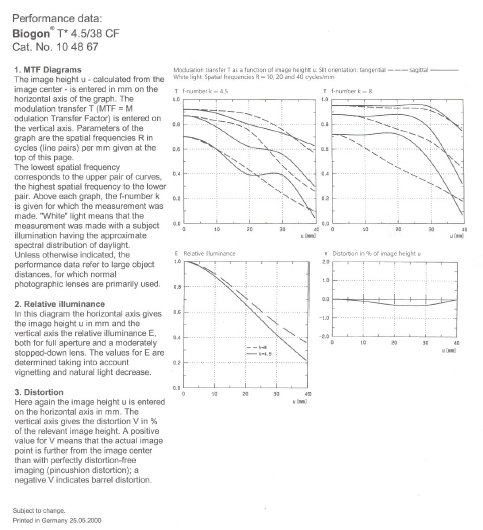

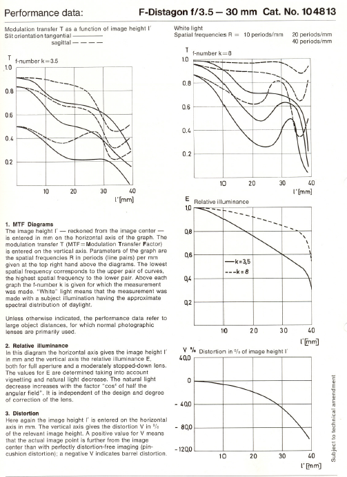

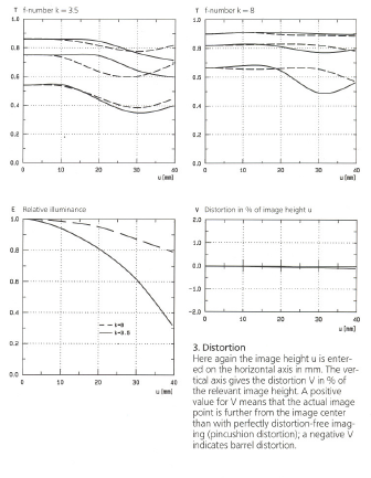

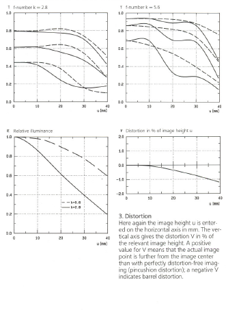

The short translation: For each plot the higher the line is as it moves from left to right the sharper the lens is. That is a perfect lens would have MTF plots straight and level at the height it started all the way across. For most people that is enough for most people to understand.
This is the 80mm "Normal" Hasselblad lens This is the 100mm Hasselblad lens
One can tell looking at the plots that the 100mm lens is much sharper across the whole field of view.
Also each lens manufacturer uses its own proprietary techniques so one cannot use the plot to compare between manufacturers.
For comparison this is the 30mm Fisheye Hasselblad lens and the SWC.
