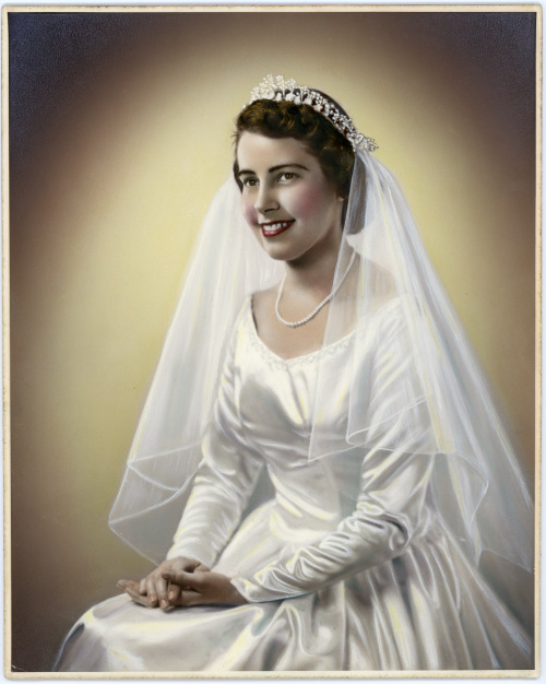

I have a collection of hand colored / hand tinted photos and RPPC's in my archive. They are buried in a storage locker and can't get to them right now. But here is one masterpiece.
