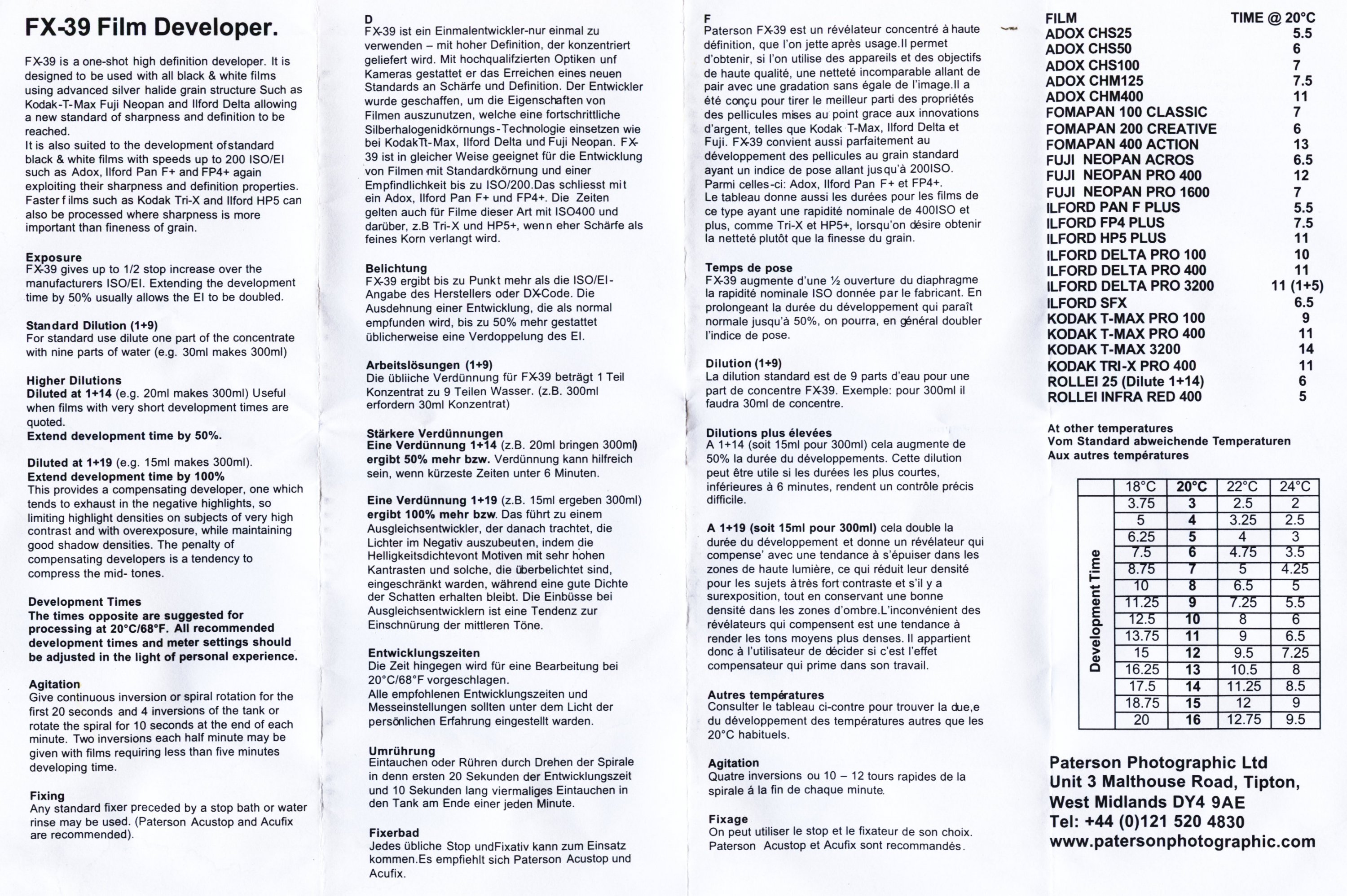

While organising my darkroom earlier today I came upon this original FX-39 leaflet from Paterson.

Interesting the linked page doesn't mention Hyfin Ilford's high definition developer, or the likely formulae, and there's nothing about the packaging both Hyfin and Kodak HDD came is packs with sachets to mix 600ml of developer.
It's also worth pointing out the the then Adox (later EFKE) Kb17 was not a slow film it was the medium speed film in their range, the issue is Adox and EFKE used the Tungsten DIN speed in the name and the Daylight speed was a stop faster. I've been using EFKE Kb14 (35mm), and later the renamed sheet film Pl25 since the mid 1970's and ironically at the same 50 EI as Tmax 100 often both processed side by side in the same tank in Rodinal and aside from spectral differences bot print on the same grade of paper.
Aside from HDD and Hyfin there were many other high acutance developers like Definol, and of course the p-Amininophenol developers like Rodinal, Certnal, Kodinol, Azol etc which give higher definition tahn ID-11/D76. Kodak made quite a few developers in the UK for the European market that were never made or sold in the US, Kodinol came from research work done by Mees and Sheppard around 1907/8 while at SWratten and Wainwright although it was decades before Kodak released it. Ilford's Certinal dates from the same 1907/8 era and was in production for around 50 years.
Adox recommends 7 min for Delta 100 (1+9, 20C) in their datasheet. Here in Paterson leaflet it is 10 min (if the time was given for standard dilution).
Any ideas, which time is correct?
