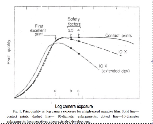

With B&W negative, the easy rule of thumb is "the more you enlarge, the less latitude"
Contact prints from B&W negatives have the greatest latitude, but mostly for over-exposure.
