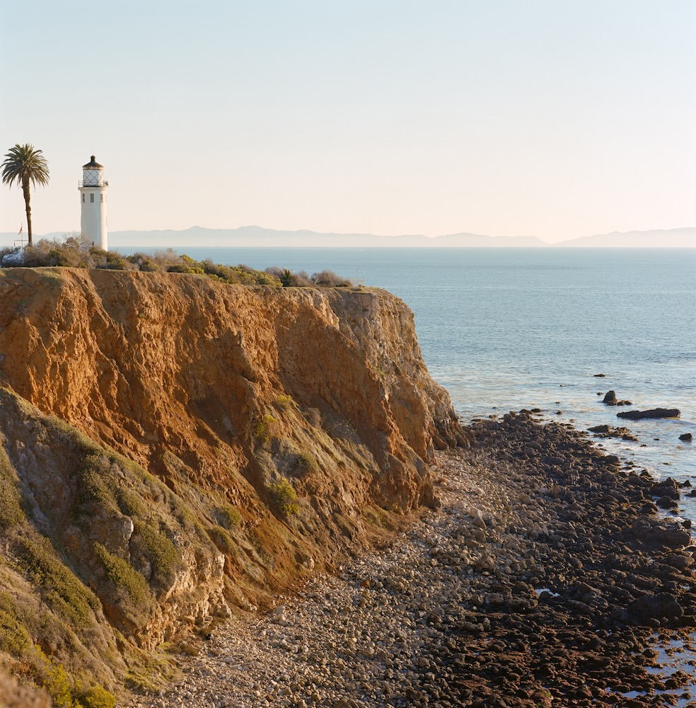

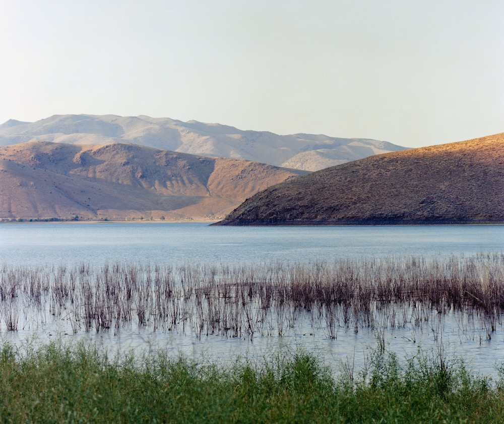

I am not the best scanner operator in the world, but with just a bit of effort the Ektar colors do not look muted or lifeless to me:
