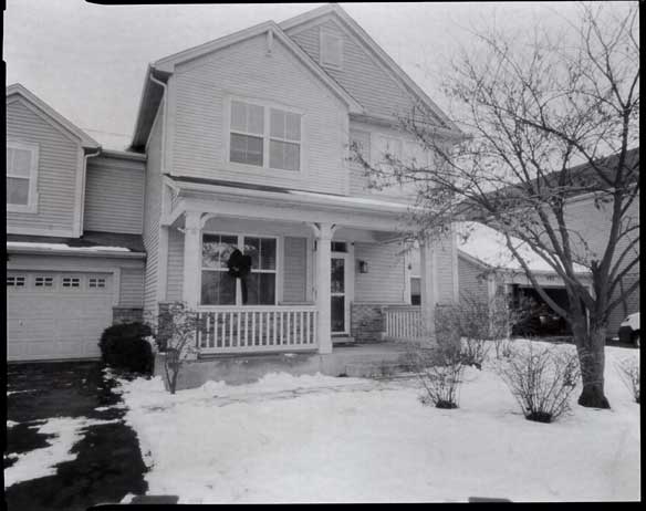

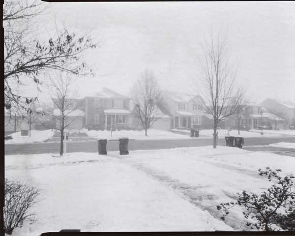

I have been using the process with normal lenses in my 4x5 cameras for a while now with great results. Must be shot at about ISO3, so is a bit slow, however. Heavy overcast midday exposure was about 12 minutes with a .3mm pinhole at 68mm focal length.
These are my first two ever pinhole photographs. I used the reversal bleaching to produce direct positives. The haze in the first photo is from a slowly-lifting fog from the recent thaw.

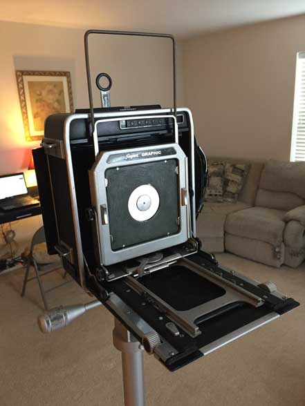

I used a 0.3mm laser-drilled commercial pinhole mounted into a Graflex 4x5 Super Graphic camera lens board.

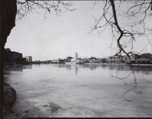

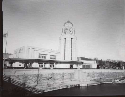

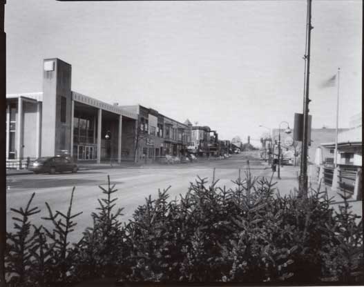

I took these pinhole shots today, partially to test out my new EV pinhole exposure chart. Worked well. All of these are direct-positive images made on cheap Arista EDU graded #2 enlarging paper exposed at ISO 3. Processing was virtually identical to that used in the old chemical photo booths. Two extra steps to reverse the image are bleaching in potassium dichromate/sulfuric acid and clearing away the orange dichromate stain in a sodium sulfite "clearing" solution. There is also a second fogging exposure to room light and second development. Fast and easy.
Note the faint "ghost cars" in the street scene. There was lots of Saturday traffic, but almost invisible in the 2.5 minute exposure.
All images taken near the Fox River and downtown Saint Charles, Illinois.
From my first 12 pinhole photos ever! I am really enjoying this!
