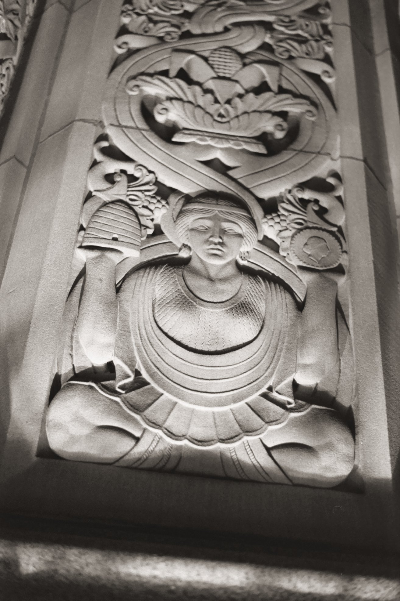

So I've got this weird issue. My first foray into 35mm film photography (well, on my own, not my parent's camera) was a Nikon F75. As long as I'm doing my part and the shutter speed is acceptable, I get tack-sharp images with virtually any lens I own.

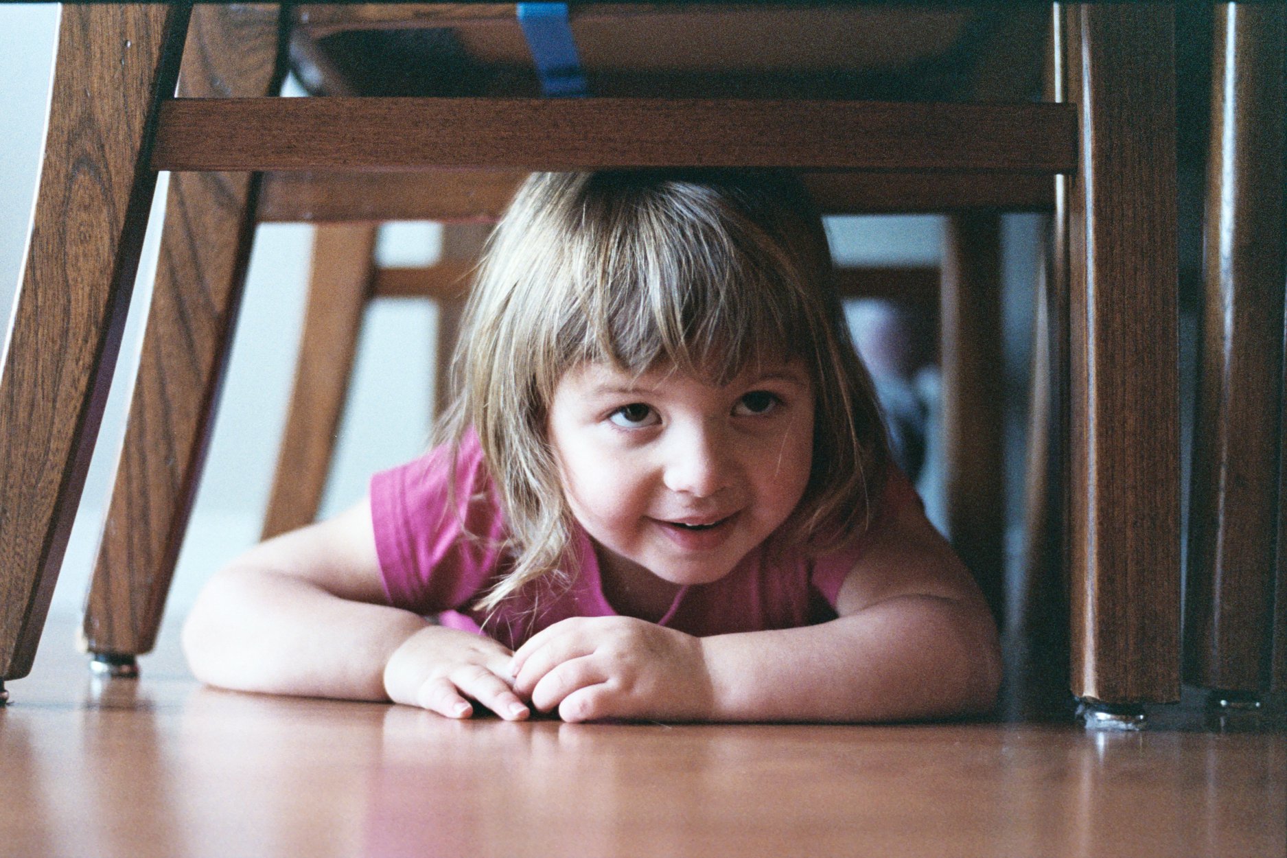

Not so much with my recently picked-up F100. I swear, it seems like the focus is nearly not as sharp, even with the same lenses. I've been meaning to get the film scanned as hi-res tiffs to make sure (as I'm using a local shop that still hand-processes film, but will only scan to jpegs under 5MB), but even with low-res scans, my F75 has always given me very satisfying pictures.
Even with my 50mm F/1.8G, I find most of the photos are just "meh".
I picked up my F100 on Ebay, and I'm in my final days of Ebay's money back guarantee / leaving negative feedback.
First picture is the F75, second is the F100: I know, different films and lighting conditions, but the overall difference in sharpness is consistent across all film and light.

Your second photo doesn't necessarily appear like your subject is out-of-focus, although the image has a softer look, to my eye. You're using 2 different films here, in different lighting conditions, so that may be a large part of the reason. I think your second photo is great - it has a classic look to it.
I'd load the same type of film in both cameras, and shoot the same subjects with the same lenses then do a side-by-side comparison of the scans. I've owned over 30 Nikon bodies, MF and AF, and have never attributed any focus issues to the camera or lens. It was either my error, or the AF system focused on a different point than I intended, which only occurred with moving subjects on older AF bodies. I've found the F100 AF to be extremely accurate even for sports photography.

It looks like to me the second shot is slightly front focused. A used camera could easily have been banged around and knocked the AF sensor/mirror out of spec. I'd just send it back and try another sample.

By the way, a note on the sample photos provided. The N75 photo is something far away, ie the focus can be all over the place but it will still be in focus given the distance which results in deeper depth of field. The second shot of the child is clearly front focused as the left leg of the chair shows. However that does not mean a camera error. It looks to me the focus point was the hair above the forehead (see fringe in middle), was that where the focus point was? That bit of hair is in the middle of the frame which is where the focus point would be. If you focused/recomposed from the eyes you could get a bit of focus/recompose shift due to repositioning and shooting up close (ie thin DOF) and wide open (even thinner DOF).
So based on those shots I don't see anything of an issue.

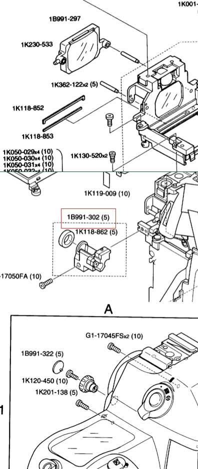

Is your F100 diopter correctly adjusted for your eyesight? If not this could cause your focus problems.
