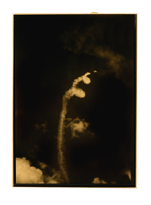

Here is another photographer who does (or did) portraits with glass+gold orotones.
His other pieces that he calls aerotones are also orotones but not sure the materials involved.
http://www.rfoto.com/aerotn.html

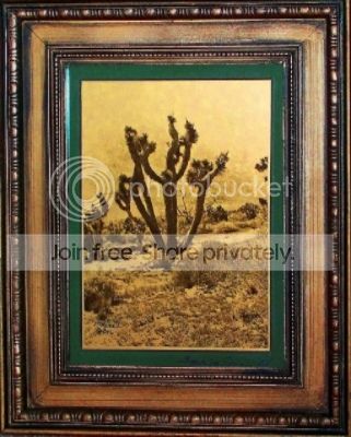

Have been trying several techniques for getting the"gold" to look right(to me).Also finding some images look better than others for the orotone effect and learning which densities to shoot for. In my opinion images shot on paper negatives appear most like the Curtis orotone images(probably because of the blue sensitivity,like older glass plates).I stripped the Joshua tree print I put up before and applied my latest "gold" backing,the wife liked it enough to frame it.

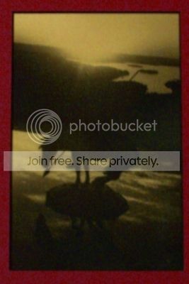

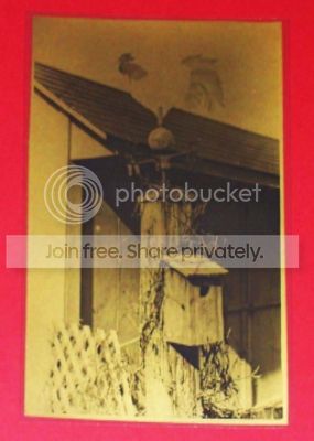

I'm having enough trouble with my digital camera that I'm shooting pics to post that think it's headed for the trash bin.one pic is correct the next way off in color and focus appears sharp on one and not on the next exposure of the same picture (nothing moved go figure).I'm going to post my latest anyway so please over look the inconsistencies...

I agree with the wife-the Joshua tree looks great!

Really nice Don!
I like number 3 very much and it reminds me of the "wild horses" monument in the Columbia river basin. Something I like most in a photograph: it makes me wish that I was standing there.
I know what you mean about digital camera photos of prints... it's infuriating trying to get one with correct colors.

I've been making orotones and silvertones For well over a decade. I have a few examples at Etherton gallery in Tucson. Silver gelatin prints on glass backed with gold or silver.
http://www.ethertongallery.com/html/artist_detail.php?recordID=139
FYI, from my research those older orotones did not use real gold. They were made with bronzing powder.
