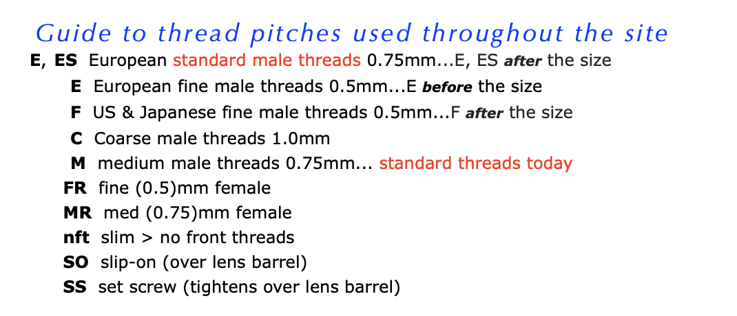

I don't know if this will help or not but the website https://www.filterfind.net/Data.html shows the following. Then again, these designations may be specific to his website, and not necessarily standard nomenclature? Your might contact the owner of this website, contact information here: https://www.filterfind.net/Ordering.html

'S' stands for Series, meaning the filter is a drop in filter without threads that uses a retaining ring. Early versions of the OP's lens took a Series 7.5 filter, later versions used a screw in E60 (60mm) filter. Leica were pretty chaotic with their filter sizes putting overall lens design ahead of filter use, so E60 is a Leica only size as far as I know. But it does give you a thread in the lens to use, so in similar cases I use a 60mm to 67mm step-up ring and buy the far more common 67mm filters. If you need more depth because the thread is recessed find a B+W E60 UV filter (or the cheapest), take the glass out (unscrew the retaining ring) and screw the step up filter onto the B+W mount (I glue mine on), and then add your chosen 67mm filter on. Given it is a 180mm lens you shouldn't get any vignetting.
