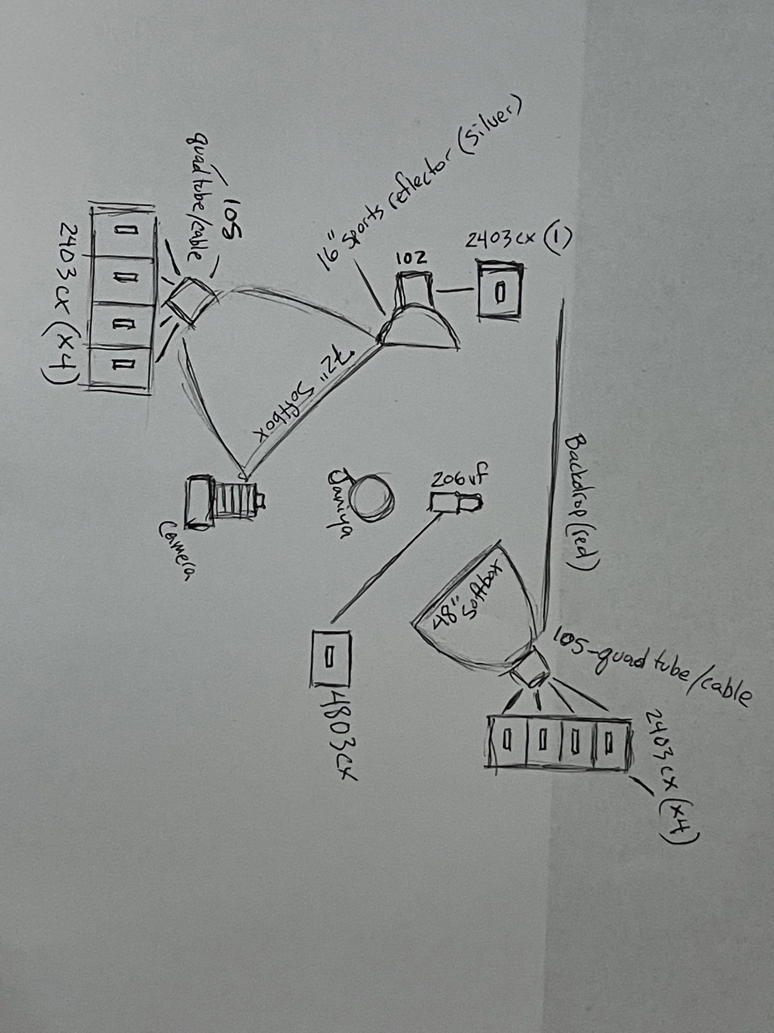

Yep, I want to experiment with the direct positive color reversal process.
The paper has a sensitivity of 10-16, and after introducing color gels I believe the effective ISO is 1-3.
I know people who shoot wet plate collodion portraits with Speedotron systems.
I won't share an example image for copy right/respect reason, but a person in Northern USA shared a portrait they did with wet plate, and they used, two 9600 ws heads (key and phil in softboxes), 2400ws kicker, and 4800ws for the background light.
I've attached the lighting diagram they sent me. The portrait is absolutely gorgeous!
Thanks again everyone!
