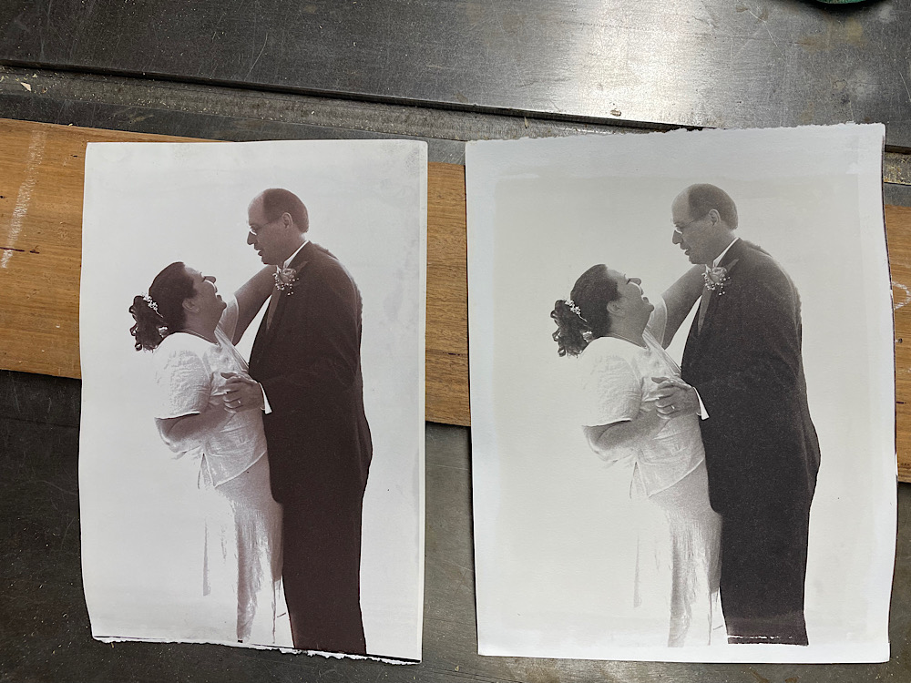

I got a gold toner kit from Bostick and Sullivan, gold chloride and ammonium thiocyanate. I tried out first a fixed and washed print and after drying saw it was a pretty neutral tone. Next I printed the same image, rinsed and toned before the fix. I suspect the toner gave out before it could go to completion because I got an interesting split tone and would go no further even with replenishment with more gold chloride.
The toned before fix print is on the left. Not sure what to make of that.
