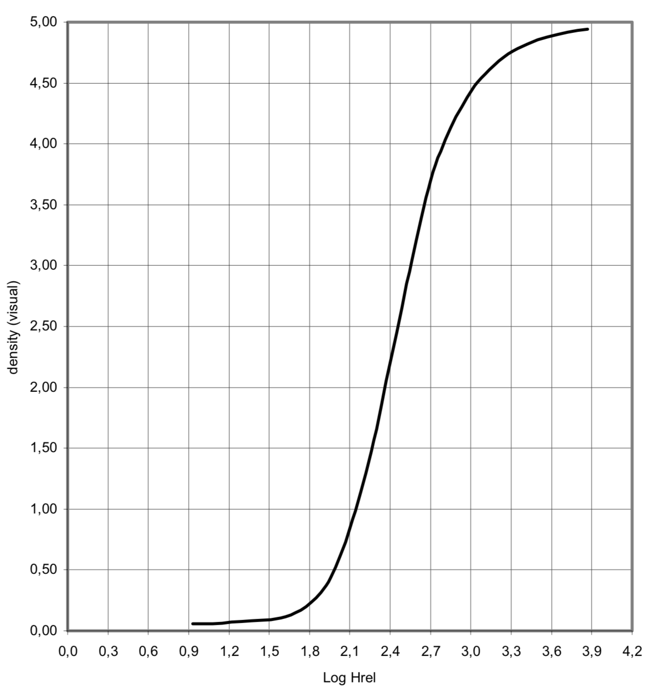

I don't know for sure if that's the same kind of film, but it might be similar. IDK how this film works exactly, only that if you look at the curves, it's pretty much a vertical line instead of a curve. So it's really tailored to give no greyscales whatsoever - which is exactly what you need in its intended application. It's possible that they accomplish this in part by incorporating a developer in the emulsion itself, or something that interacts with the developer. This is what I take from the Reddit post and it makes sense to me. The sulfite pre-bath might act to get rid of those compounds in some way. I'm just familiar enough with this product by far to say anything more sensible about it.
Yes, I am familiar with the concept. The Foto-32 film that I have been experimenting with is also like this, giving ultra-high contrast and almost no grayscale if developed with normal developers. I am pretty sure it (along with the former Washi-S) is TF 12d, which has an impressively vertical H&D curve.
