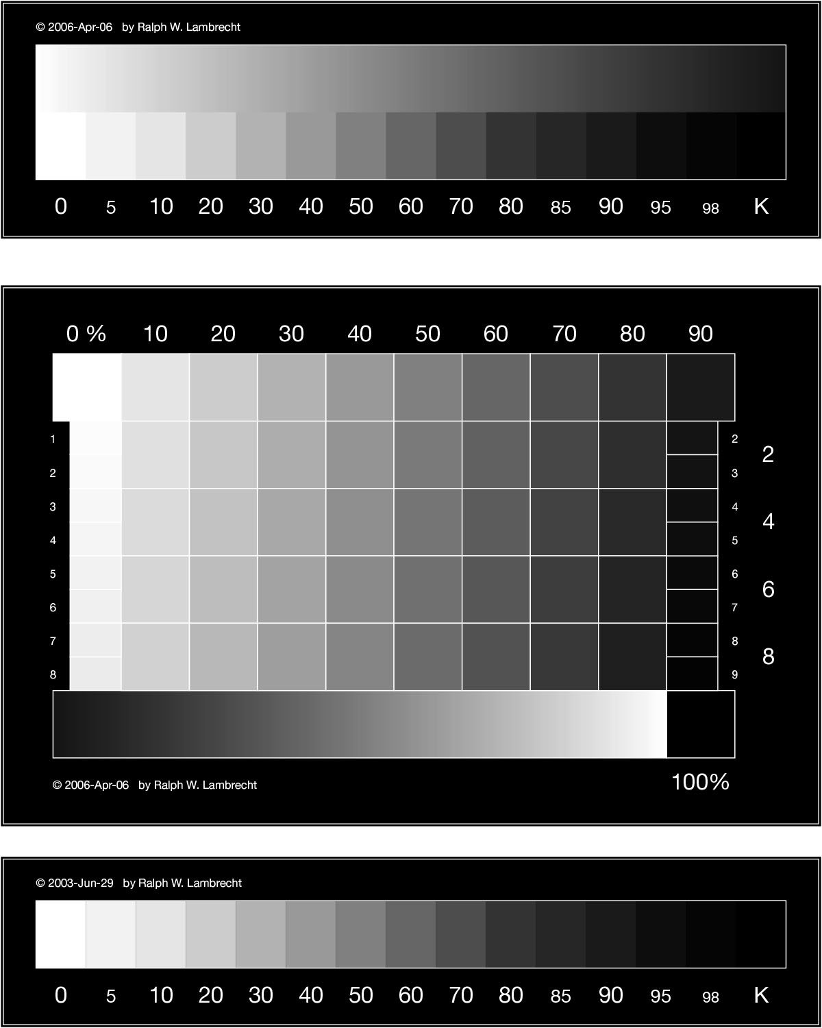

Yeah, that's the ideas far PS can do all I need; to figure out the adjustments, I'm using the attached step tablet.

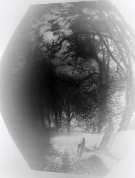

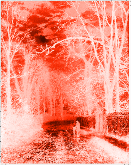

I'll pretty much try anything if it sounds interesting enough. I took this Grimshaw painting:
Desaturated, inverted, and colorized it to this:
Then I rotated it 90 degrees clockwise and displayed in on my laptop full screen.
Then I put my laptop in the closet, and put an existing pinhole camera on the keyboard facing the screen.
It seemed pretty darn bright, so after 1 minute I developed and the paper was still white.
I tried again using 16 minutes and this is what I got:
Looks like it could work if I left it for a couple hours, but I don't want to leave my laptop on w/the same image that long.
It would probably be possible to account for the light falloff in the pinhole camera, but I don't think I'll fuss with it any more.
I did give it one more try... I had a feeling the falloff was more than just normal for pinhole. I even made the area around the outside a little brighter before I tried. The pinhole idea will not work with my laptop because as the angle to the pinhole increases, the light reaching the pinhole from the screen is reduced. And there are sharp lines where it changes that must have something to do with the pixel structure on the screen. This pinhole camera has complete coverage of the paper, none of this is due to the geometry of the camera:
The much darker area in the center must also be a result of the screen... no photograph with this camera has a central spot so pronounced.
Reminds me of something I read that some lenses made for film SLRs don't work well on digital cameras because the sensor can't handle light coming from much of an angle, whereas with film it matters much less. As I tilt the screen, I can see the light dims a lot, but with my eyes there is no obvious point where it changes suddenly. Could even be something complicated like blue more in the center, then green, then red...
