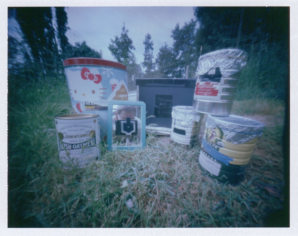

Here they are ready for tomorrow:
Left to right:
1. Anamorphic Oatmeal can, 5x7 paper.
2. Hello Kitty popcorn can, 11x14 paper.
3. In the mirror is the "pinholaroid" making this photo, FP100-C.
4. Matboard box camera, 8x10 paper.
5,6,7: coffee can cameras with 5x7 paper.
I hope everyone has fun and will link to their WPPD photos (there was a url link here which no longer exists) too!
