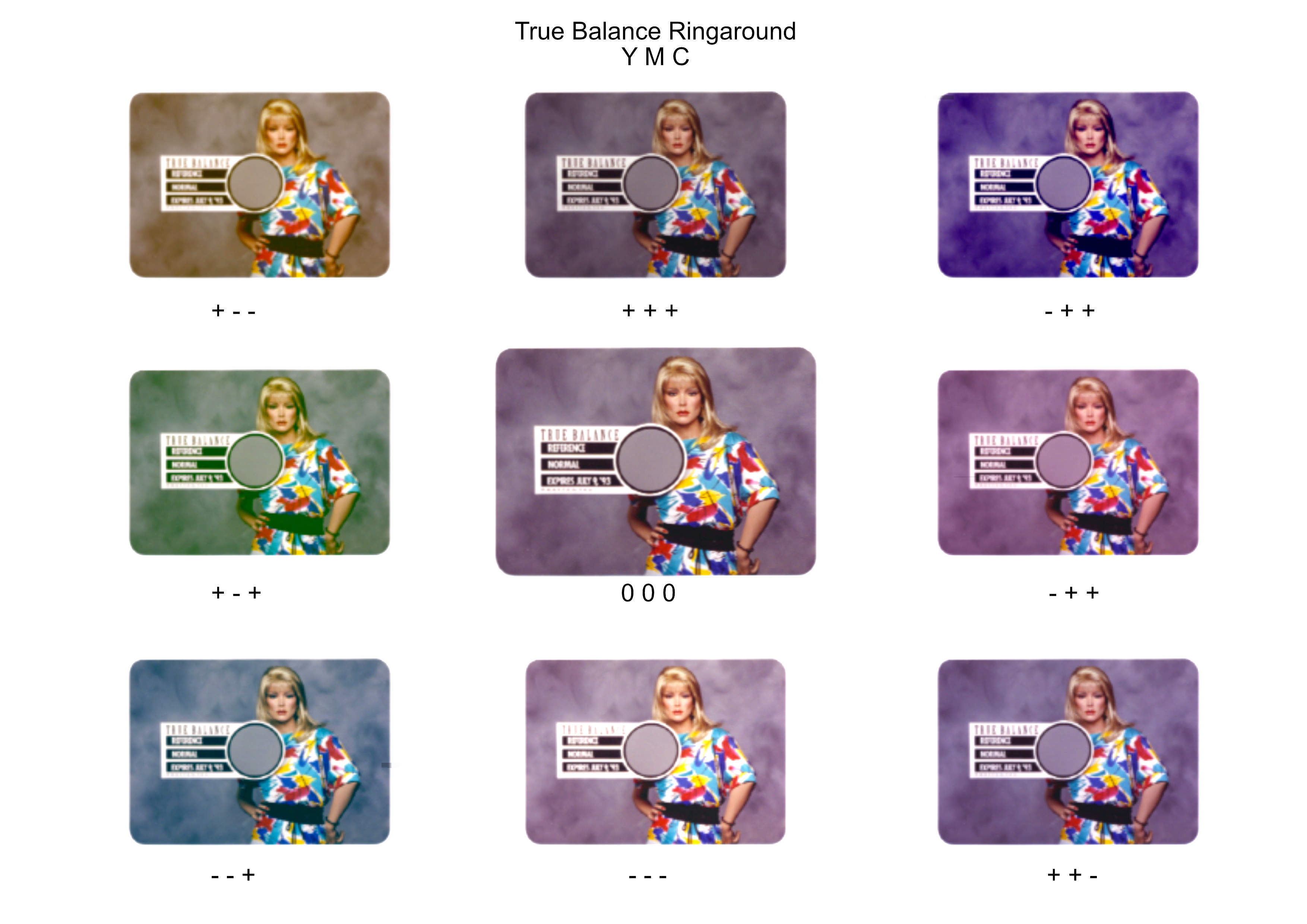

A few years ago, (I owned a minilab) I had a customer who always complained about the colour of his prints (yes, he kept coming back!!!) So I did a set of ring around prints (see thumbnail example)
Customer selected a corrected colour not the neutral densitometer one. When we rescanned and printed his order with this colour correction he was happy (everyone in the lab thought it was the wrong colour). So it just goes to show.
