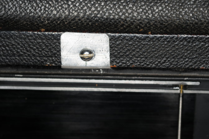

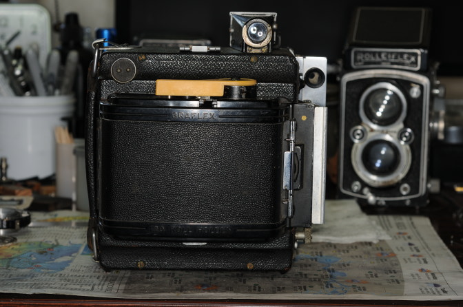

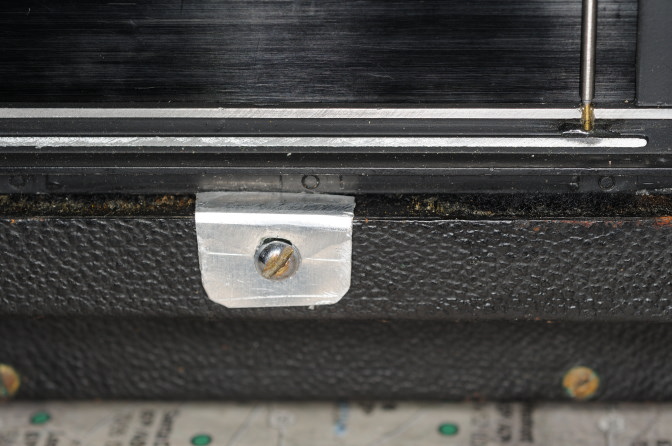

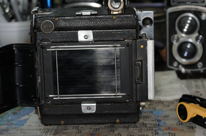

Miniature Speed Graphic with RH10 Graphic roll film holder attached with home made retainers.
Fully assembled, insert removed, top retainer, bottom retainer. Scrap pieces of .035 aluminum used for the retainers.
