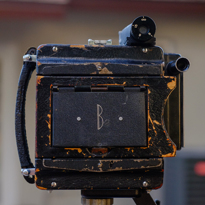

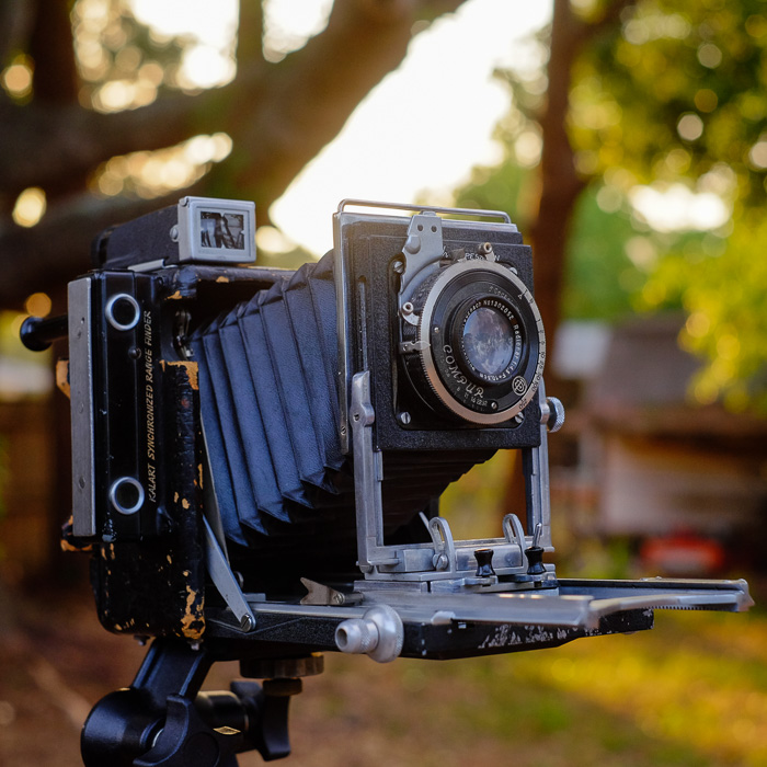

I've been wanting a large format camera for a while for the big negatives and use of camera movements. But, I realized that until I get a large format enlarger, a large format camera won't do me much good unless I want to contact print. However, my enlarger can handle up to 6x9, so...

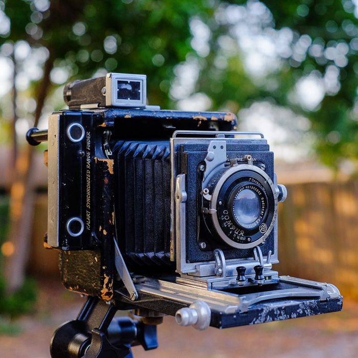

I picked up a Busch Pressman C, a nice little 2x3 press camera.
I got it for $30 on ebay, an auction that included a dozen cut film holders. For that price, I can't be too upset with the rough condition it came in.
The leather cover is beat up. It is missing the stops on the rails so I had to figure out the correct location for the front standard to sit so it focuses correctly. The sun shade that blocks incident light from hitting the ground glass is in poor shape. It is missing he button on top of the camera to release the cover when it is folded. The lens is fogged and it is actually the lens from an old Balda folder (from my research online), not one made for the camera. It took a decent amount of fiddling to even get the camera to open as it was not put away properly the last time it was used.
However, those are the bad. Now for the good things.
The shutter works perfectly and is completely accurate. The focusing racks in and out smoothly. The Kalart rangefinder works and is ACCURATE. All movements work perfectly. The lens actually covers most movements. So, it checks all the important boxes.
Some more pictures:
4 of the film holders had film in them, so I exposed them as test shots with this camera and I'll develop to see if the film was any good tonight.
I'm excited to use it and to learn more (read: anything) about camera movements! I have some Arista 100 cut film on the way along with some Instax Mini film to use in my film holders. I want to pick up an Adapt-A-Roll 620 eventually so I can shoot 120 film with it. Maybe some tintypes too!
I still want a large format camera and I'm sure I'll get one eventually, but for now, this little guy will do.
If you've shot with one of these or with the similar Graflex equivalents and have any tips or things to try, let me know!

The Radionar is a triplet and yours is a bit "long" for the format, which means more coverage for movements. Stopped down to f:8 to 11, it will be pretty good. I think Schneider made a 105 Symmar, I know they made a 135 Symmar which would give all the coverage you could wish, plus be sharper across the frame.
Cleaned up, you'll find the Radionar quite nice I think.
I'm not sure I know what you mean by "long for the format". It is 105mm, which is just about "normal" for 6x9, right?
In any event, I'm excited to see how it performs. I also picked up a 101mm f4.7 Graflex Optar in a graphex shutter for pretty cheap from someone here on the forum, which was the standard lens (just branded for Busch and not Graflex) with this camera. So, I'll try both of these lenses out and decide which I like better. They're so similar in focal length it doesn't make much sense to keep both.

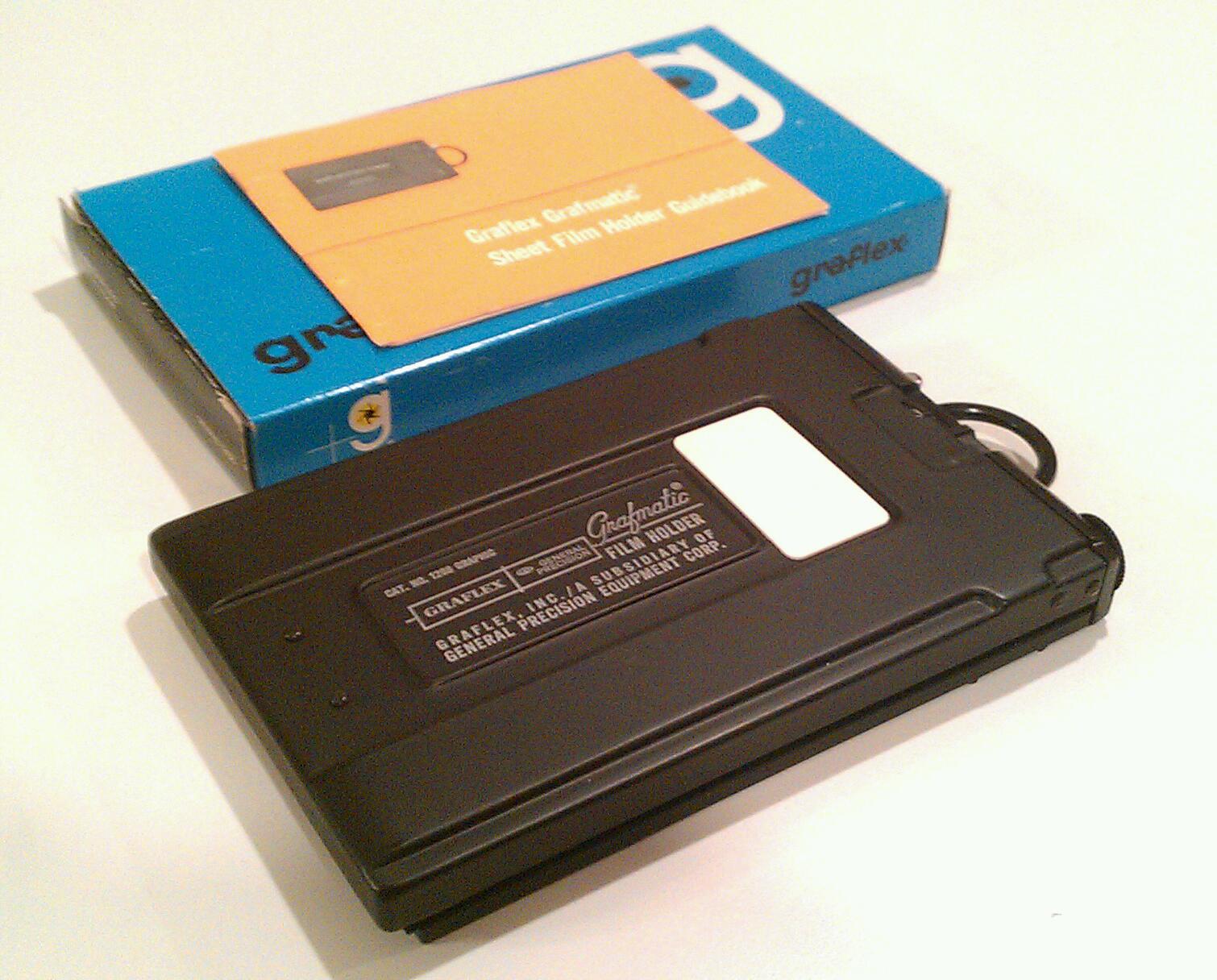

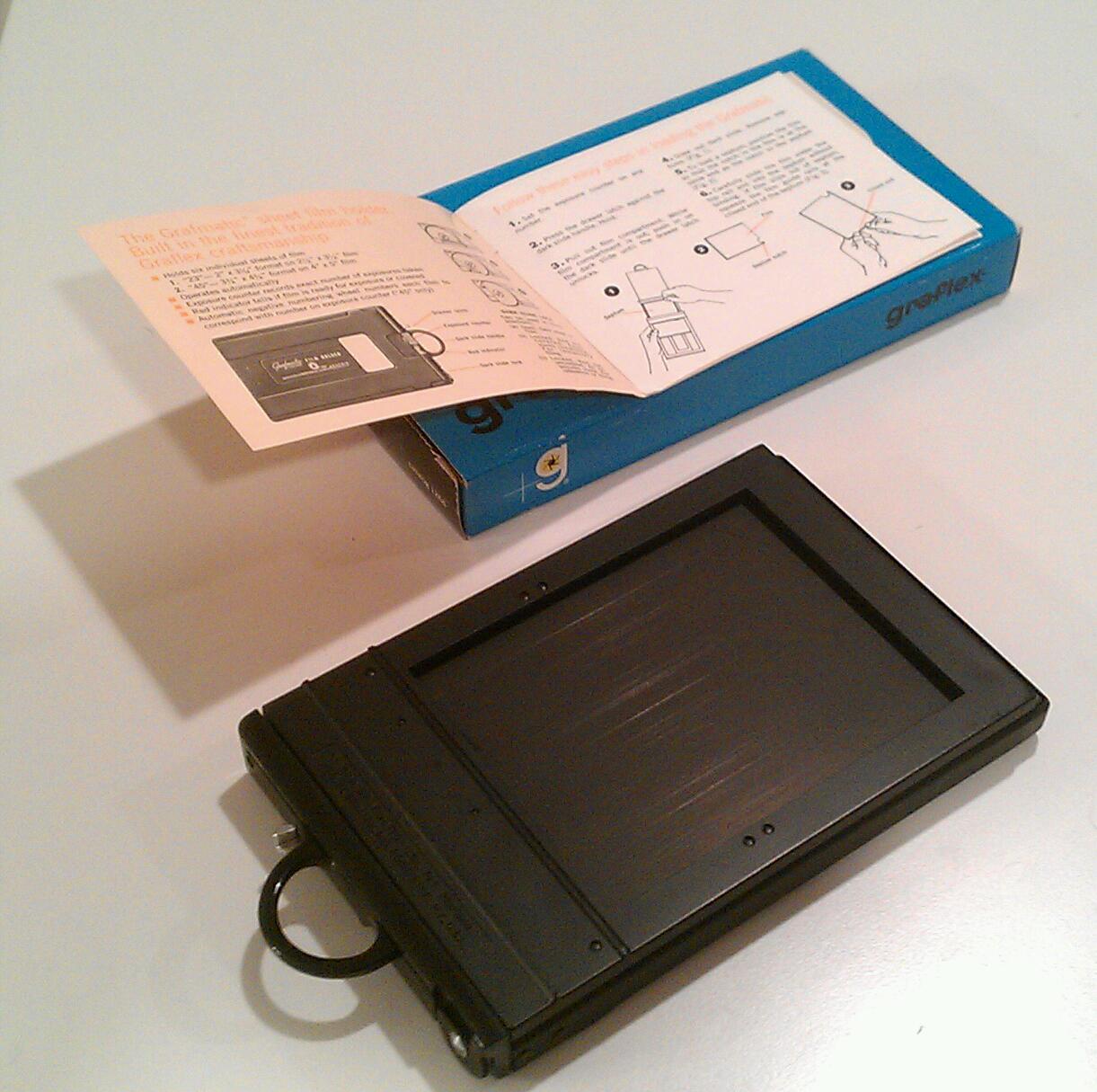

Better yet get a Grafmatic 45 and shoot six sheets of film. https://graflex.org/speed-graphic/grafmatic/
I haven't seen those before, and its a pretty cool bit of engineering. Not sure if it's worth the $50 they seem to fetch, but cool nonetheless.
They are very convenient and fun to use. A clever bit of mechanical engineering went into them.
Usually, the ones I find in decent shape (nothing missing or broken) are about $75 -- that's for 4x5. However, I got lucky and found this new-in-box Grafmatic for the same price. It's very old, but looks new.
If you find a good Grafmatic for $50, jump on it! They're great accesories.

I'm not a huge fan of the Grafmatic film holders. I have a 45 and while it's supposed to hold six sheets of film, I find it jams up frequently when I try to load all six. It does a lot better if I only load five. Also, I like being able to write directly on the film holder what shot I took and any special developing needs. With the Grafmatic, you can still take notes on that, but I find it more cumbersome and confusing. All in all, it's an okay device. It's certainly fun to use and an interesting piece of engineering. But I don't like taking chances with my sheet film. It's just too expensive.

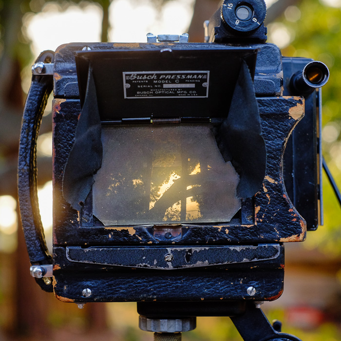

I also cleaned the camera up last night. Took out the ground glass and cleaned it, repaired the light shade over the GG, cleaned the viewfinder and rangefinder glass, and cleaned the lens. Those things made a huge difference. Looking forward to shooting more with it!
You have at least one bent septum, mine work flawlessly and are invaluable for hiking and action photography. Yes you can photograph action with a Technika.

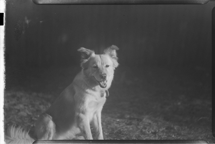

Here's one of the shots from yesterday:
Like I said, it was a very thin negative because I didn't know the film's ISO and didn't know how long I had developed it for. It took some work to get a decent image but it showed me that the lens is entirely adequate. And that my dog is a good sport with all of my fiddling with film holders and dark slides.
None of the other 8 shots were really usable. Oh well, it was free film and I used replenished XTOL so didn't even cost me any developer!
