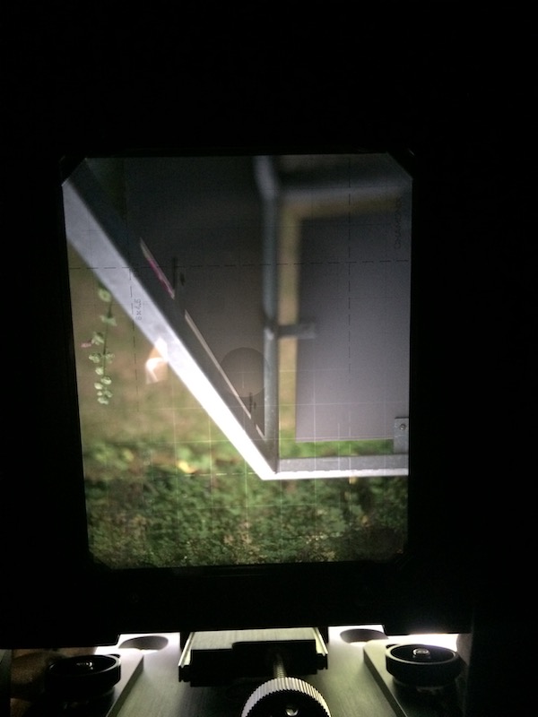

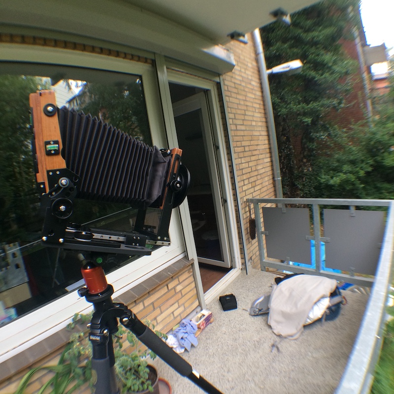

umm, that was simplification, I think:
a) asymmetric tilt (on the back) is really quite handy for specific situations, like some line going through the shot front to back of the image, while using swing on the front for Sheimpflug… (difficult to explain, easier to show – VERY clumsily).
The two images show a situation, where I used asymmetric tilt to get the rails sharp all the way front to back (was not – yet fully – though) while first focusing on the corner of the rail. With just tilt I would have had to adjust focus on that point.
b) the weight difference between the folding and non-folding is something to compare directly: F-2 is 1500g, the H-1 is 1950g, so that's 500g difference actually and indeed significant in my opinion. Both F-2 and H-1 have asymmetric tilt,
H-1 has swing on back thus the weight difference.
Cannot say anything about the N-1 …
[edited to include images]
View attachment 236712 View attachment 236713
