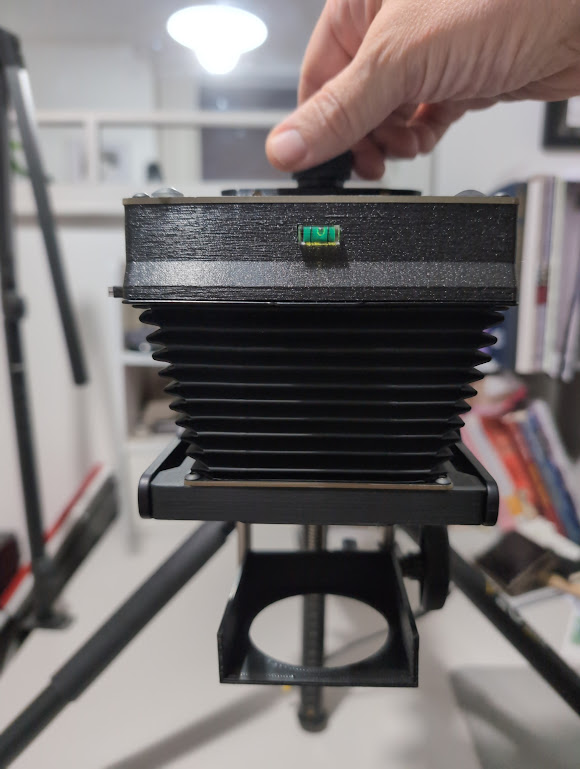

I wrote up a blog post collecting the various things I do to make life easier working with an Intrepid Enlarger (mostly the compact, but also the 4x5). If any other users out there have tips I'd love to hear them and add them to the page. Hopefully it's useful for someone.
I used an old Durst enlarger column and base board to mount my Intrepid. To get it far enough away from the column, I got a short tripod center column, any one will work as long as it’s threaded at both ends.

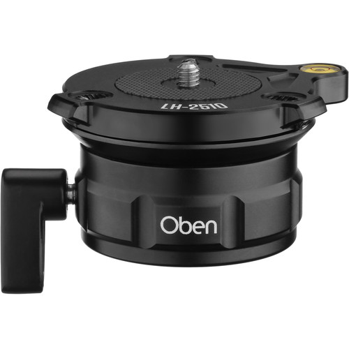

To level the intrepid i used a small leveling head similar to this one,
The enlarger columns are hard to come by in the UK (without an enlarger attached to them), and heavy duty copy stands are *bafflingly* expensive. I get by OK with the tripod. Since my setup is "temporary" (everything has to get tucked away when I'm not printing), the trade off with the tripod works out OK.
I do have a levelling head, I might try it next time instead of the ball head, I think the levelling head is less likely to slip, especially with the 4x5
