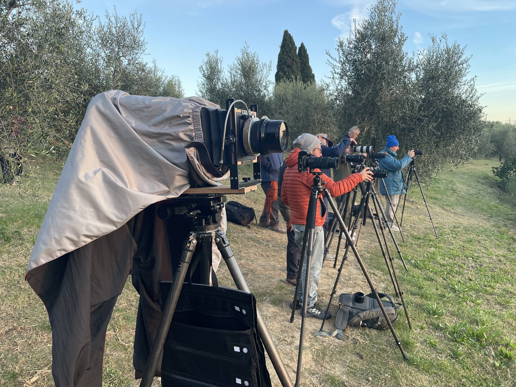

If you take a couple of considerations you can use heavy lenses on the intrepid 8x10.
Here’s a Nikkor APO 480mm front mounted on a shutter. Not a single issue.
