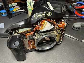

I would like to ask if there is any interest in a tutorial on the topic mentioned.
It is about the basic approach to repairing and servicing an electronic SLR for which technical instructions are available.
I would do this using the Canon T90, which is the one I currently have the most experience with.
It should be a general approach with no guarantee (and obligation) of success.
But if you can't find anyone who repairs your electronic SLR professionally, you have no choice but to try it yourself. Otherwise the camera will remain defective.

Since I am convinced that the reputation of electronics for being complicated deters many DIY enthusiasts from electronic SLR repairs, I would like to keep it very simple here. But it doesn’t work without preparation.
I recommend approaching it in the following steps:
  1. Familiarize yourself with the basics of analog electronics. Ohm's law explains the relationships between the three fundamental electronic quantities: voltage, resistance, and current. This will help you understand most of the electronic work in cameras. There are many offers on the web, so choose what suits you.
  2. Get a multimeter to measure these quantities and continuity. The latter determines whether sufficient current can flow through an electrical connection. This is important for troubleshooting. I like working with this multimeter, which costs EUR 18. It's sufficient for my work.
  3. Learn or practice soldering. You'll often have to solder and unsolder cables and make and break solder joints in SLRs. For this, you'll usually work with the lead-based solder used in the cameras. It's recommended not to mix lead-free and lead-based solder.
  4. Get repair manuals for your camera. Especially the SPT Journal, the C & C Guide, The Camera Craftsman, and the manufacturer's service manual. You can find much of this on Learn Camera Repair. It takes some time getting used to the language used there; it's concise and technical. But in return, you'll get first-class instructions and won't have to fiddle around with things.
  5. Get an SLR for spare parts of the same type you intend to repair and try to follow the instructions in your technical documentation. You can open the cameras, get your bearings, take measurements with the multimeter, identify components, and practice disassembling and soldering. This will give you practice and help you determine whether you enjoy this work.
  6. Take your time with everything and see it as a journey of discovery.
  7. Never open electronic flash units, cameras with built-in flash units, or work on devices powered by mains voltage. This is dangerous due to the high voltages involved. Check your technical documentation to find out what voltages may occur in your SLRs and other devices and find out whether these voltages are safe. Also, keep in mind that high currents can cause heat buildup due to a short circuit.
Everything else follows naturally 🙂
All information provided without guarantee and use at your own risk.
