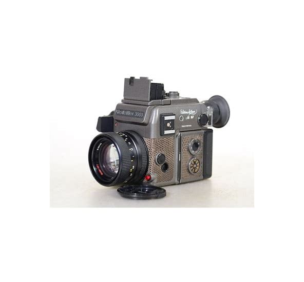

I loved my Rollei 3003 which was a 35mm SLR with interchangeable backs. Used one for color transparency and the other for B&W.
