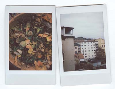

Going through kids Instax pictures I couldn't find any that were terribly exposed. They have Instax 8 mini (the cheapest Instax camera at the time).
I was surprised to find that the camera still had half a pack unused (probably 3-4 years old now) so I did two test shots:
I would call those exposures quite usable. For the test I used camera's suggested exposure. Otherwise I would use one position darker for the left picture.
The "suggested exposure" (the icon symbols for sunny, cloudy, rainy, and "house" for indoor, presumably with flash firing in all cases?) match my Mini 9, which none the less invariably overexposes indoor flash within about eight feet (and probably underexposes past ten) -- at least enough that light subjects lose detail while dark ones retain it. I haven't done many outdoor photos with mine, nor have I shot color in it (got a pair of 2-packs of Monochrome when I got the camera; still have 7 left in the second pack, second box unopened). Manual exposure with my LomoGraflok and the focal plane shutter of my Annie Speed usually underexposes, but that could be due to the (80+ year old) shutter needing regulation. I'll have to try the LomoGraflok on my Graphic View II next time I have it out; the shutter in its 150/5.6 Componon is very accurate, based on past negatives, and I have a Tessar 135/4.5 as well as a Tele-Tessar 250/6.3 (maybe f/8, I don't recall).
