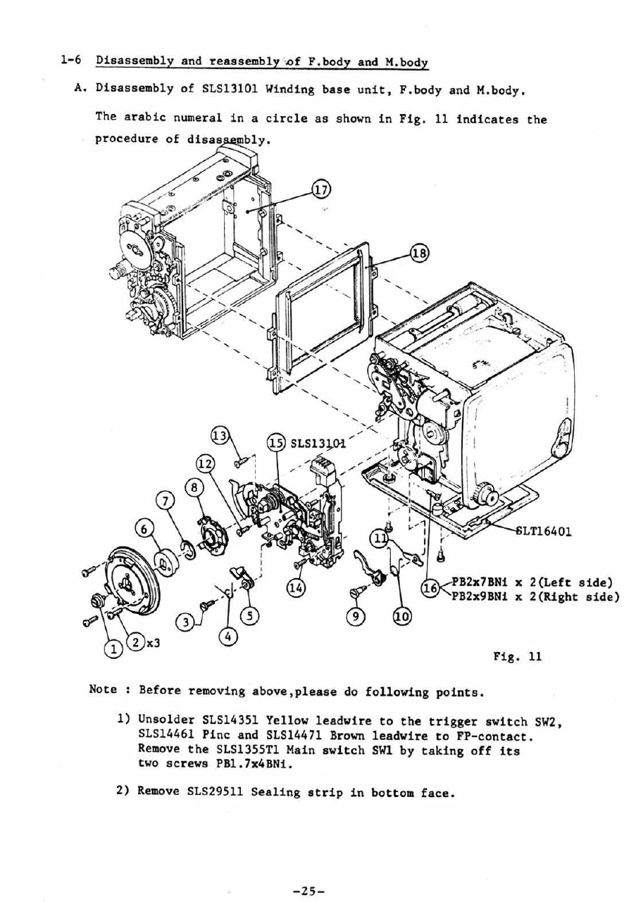

According to this diagram, the M645 body actually consists of two different parts, which from the looks of it could function independent of each other with some modification.

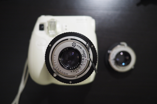

It is feasible. Please see my modification of Instax Mini with a Yashica lens.
Please refer to my blog for more details:
http://instaxmagic.wordpress.com
