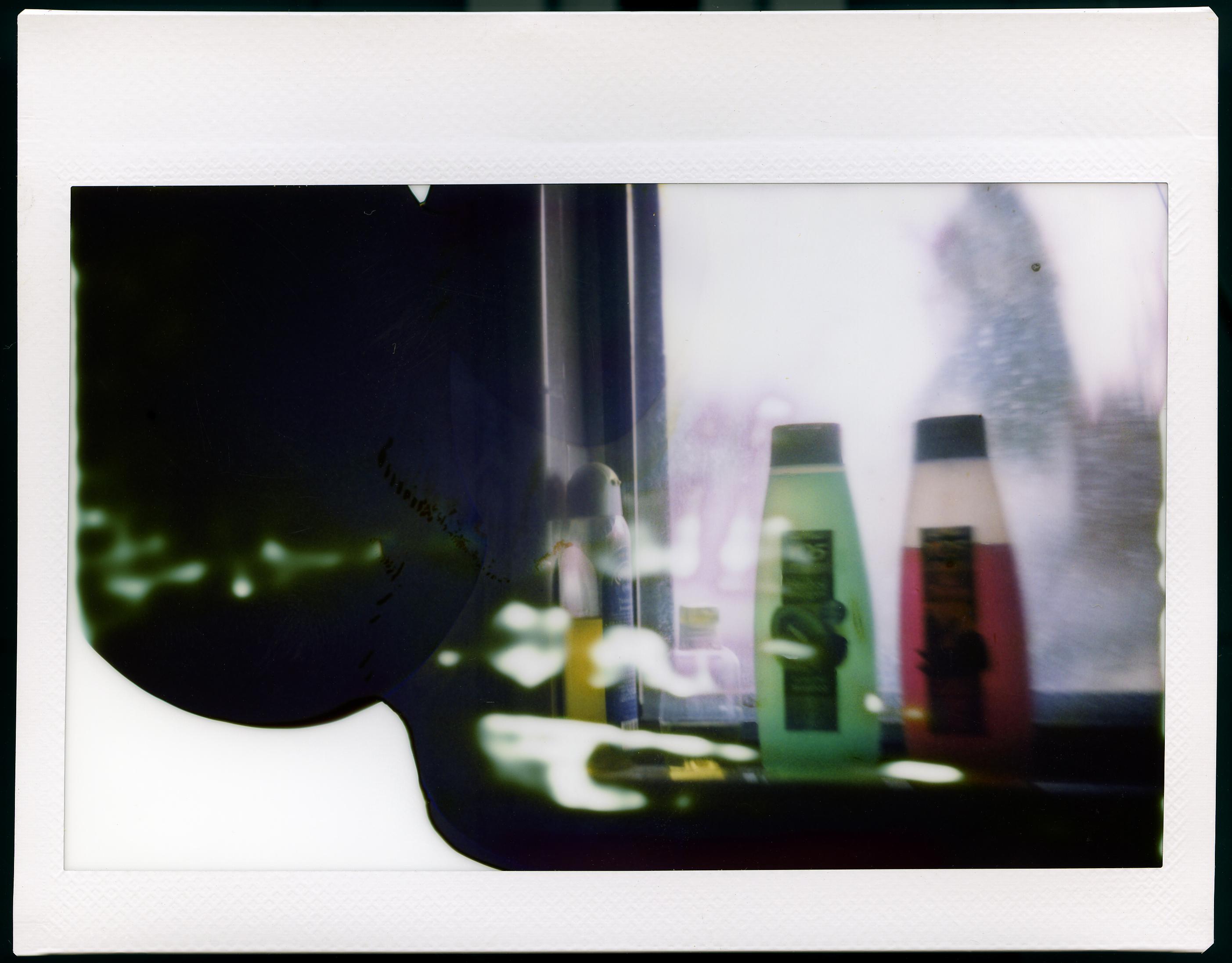

that's a good one, except for the missing bit, the colours are really even.
how are you exposing them, just sticking them in a sheet holder?
yup

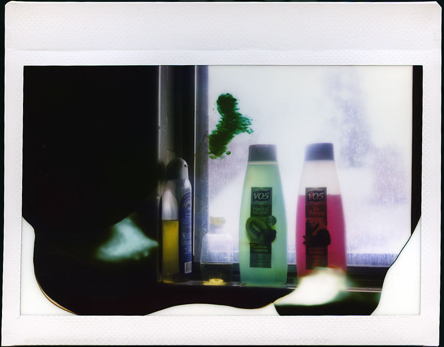

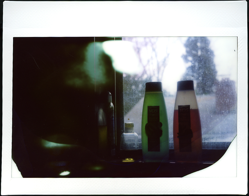

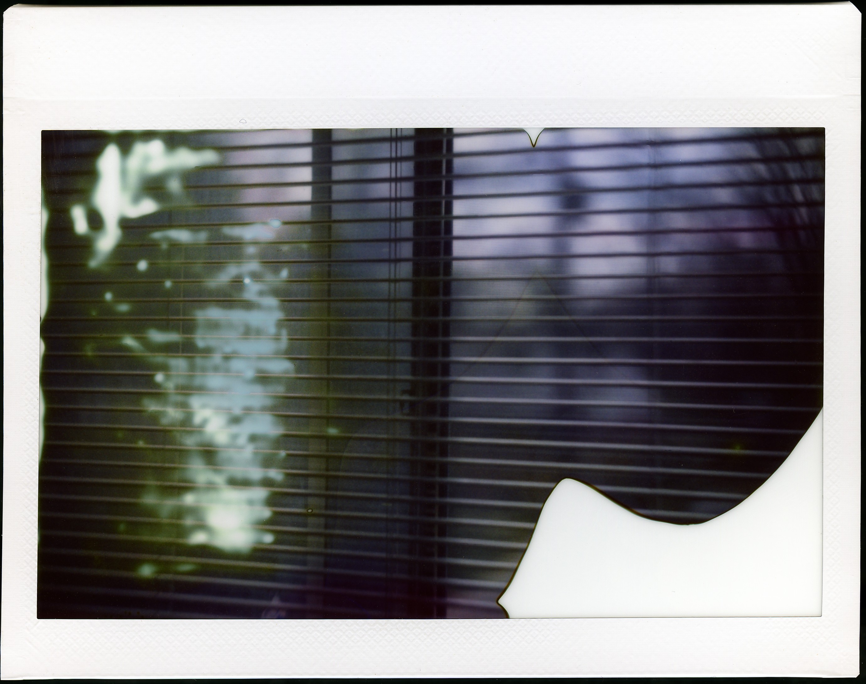

Behold my latest attempts and such!
These first two were with a petzval and processed with the standard beat up enlarger baseboard and wine bottle full of water;
I actually tried using a rolling pin, but the spindle was fixed and actually provided inferior results to the wine bottle.
I did somewhat improve my results by taking a smooth glass cutting board and placing it on my enlarger's baseboard.
These were with my 152mm Ektar
I have to say, this film scans better than any other i've used... :wink:
himself
Apr 8, 2011
513
it looks like you keep getting the same area of undeveloped film...
do you think there's any reason for that?
Prof_Pixel
Feb 17, 2012
1,917
Penfield, NY
Based on my 7 years working on the Kodak Instant Photography System, on which the Fuji Instax film is based, a lot of technology went in to controlling the DLT (Developer Layer Thickness). You had to put enough 'goo' into the pod to be able to cover the entire image area, avoiding putting too much 'goo' in the pod so you would overfill the trap at the top of the film unit which would cause a leak. If I remember correctly, the burst edge of the developer pod was designed to burst in several areas resulting in several 'tongues' traveling across the image instead of just one 'tongue' moving down the center. The multiple 'tongues' gave much more even spread. In addition, the rollers were specially ground to help give a more even spread as well.
I'm glad you are having fun.
himself
Apr 8, 2011
513
so a case of uneven pressure across all the frame, would that also account for the colour variations?
the bits that aren't spread entirely being thicker and thus developing differently?
EASmithV
EASmithV
Aug 22, 2008
1,984
Virginia
heh. I'm surprised i'm getting results at all...
Prof_Pixel
Feb 17, 2012
1,917
Penfield, NY
Since you aren't quite covering the entire image area, you need to press a little harder. You might want to try placing a metal shim on either side of the picture unit to control your spread; obviously this will require trial and error with different thickness shims.
Like I said "Have fun!"
