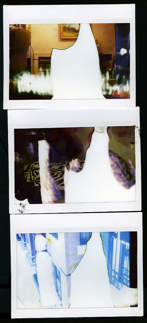

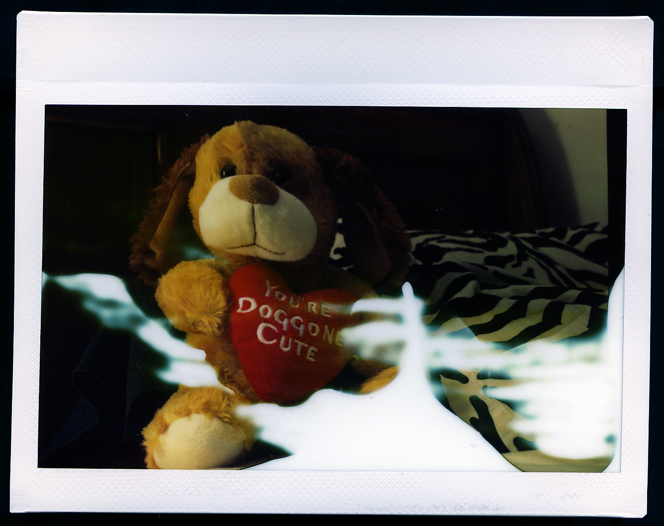

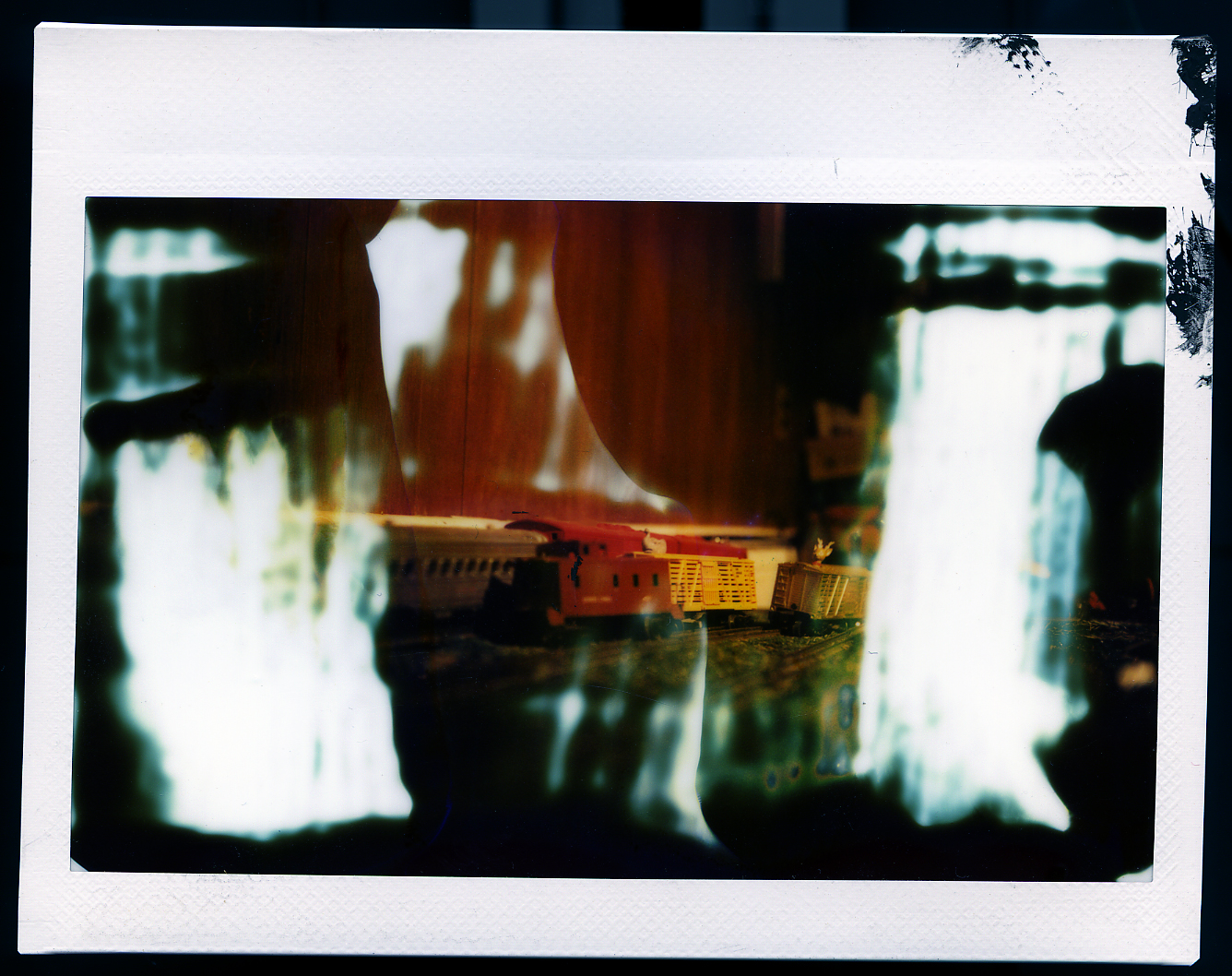

Well, here's my two most successful, some trains and one of my GF's stuffed animals...
Apparantly I wasn't allowed to use a kitchen rolling pin for chemicalley-stuff so I took a large wine bottle, filled it with water and tried to use it instead, with mkixed results... I need a better way to do this, yes, but I have to say, I like the film from what little I've seen of it so far. Fuji needs to make a better camera for such nice film.

wow, that's worked, well almost great :wink:
worth trying to get it right for sure, have you tried pulling it through your other polabacks yet?
edit: forgot to mention, that you could also do some selective developing like this, once the chemicals are cracked you can just manipulate it with you hands

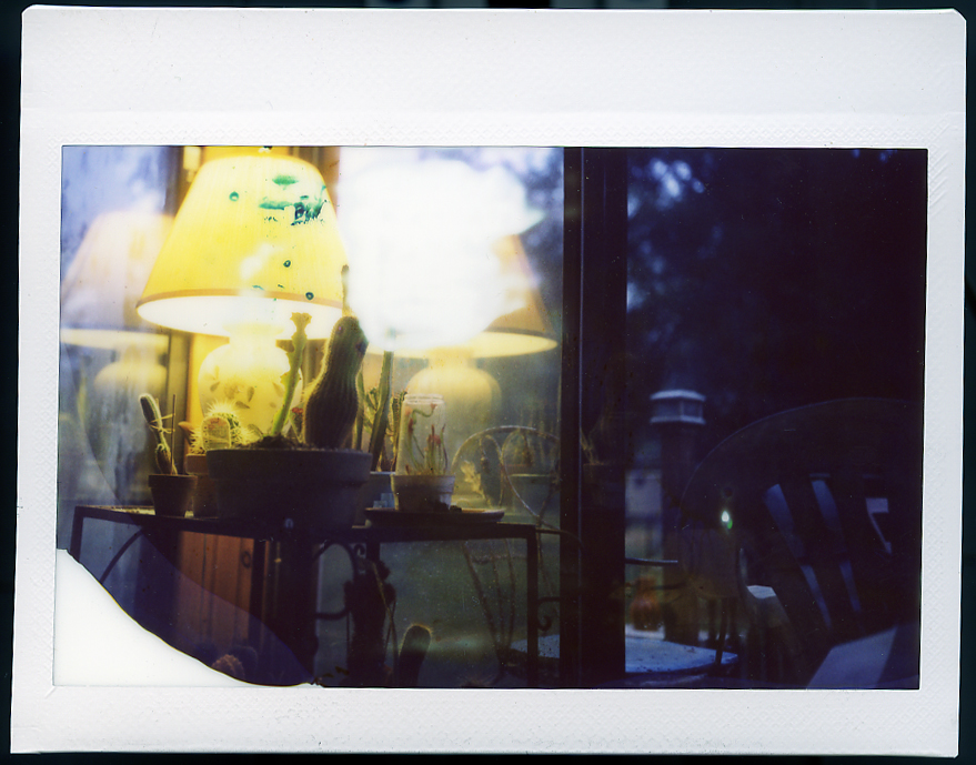

It seems that there is a consistancy in my uneven development... Perhaps it is an unevenness in my bench I don't notice that causes this.
The last one is me attempting to enlarge a 35mm slide... Looks like my cold light head just isn't helping the color any...

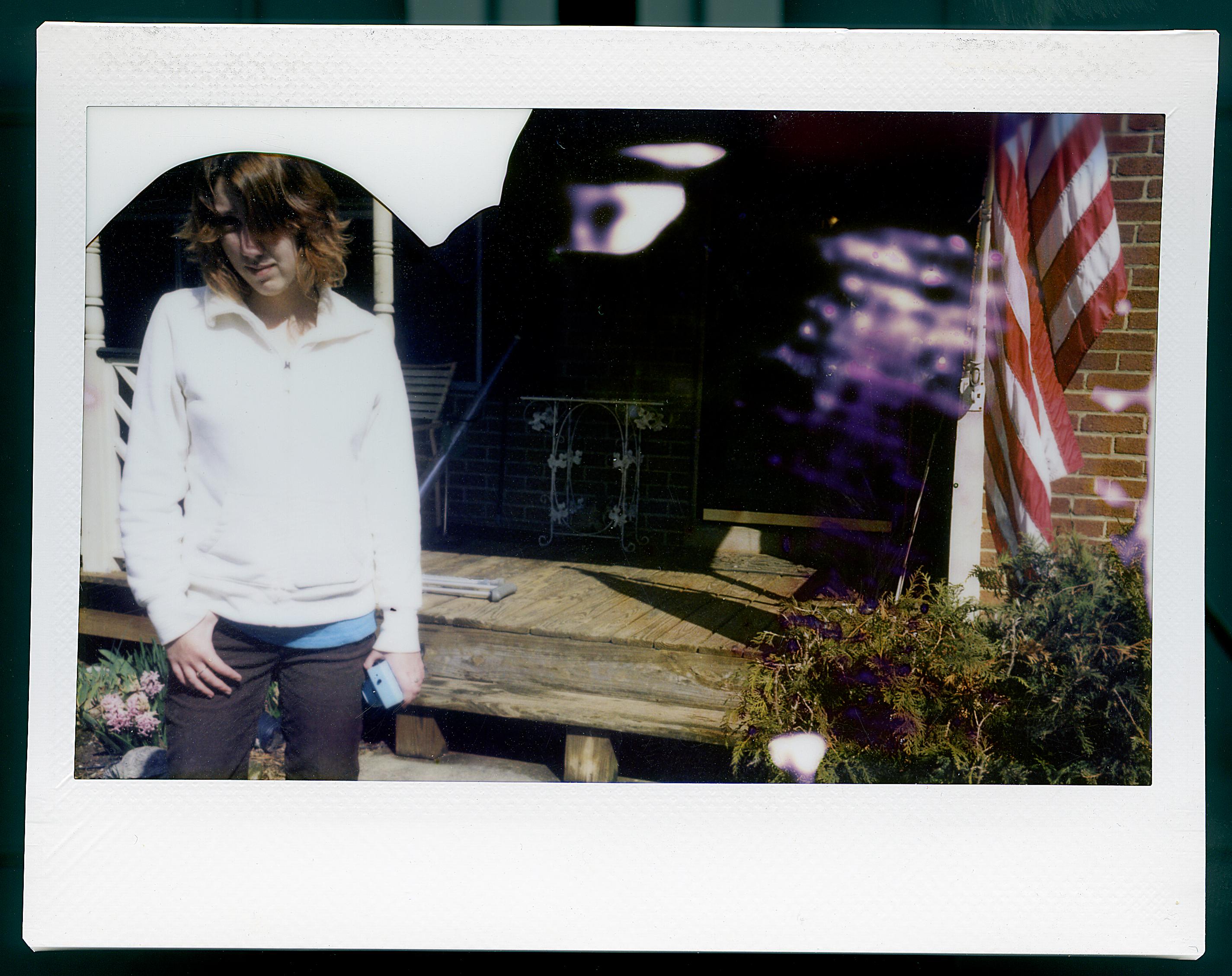

YES!
It was the worktop!
I used my enlarger baseboard and got much much more even development;

that's a huge improvement...
just imagine what a real rolling pin would do to :wink:
