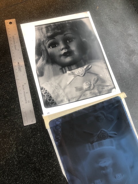

I've posted about this elsewhere on this forum in the alternative processes thread but I think it deserves a bit more exposure (no pun intended) than being buried at the end of a six (so far) page thread, and it's really just an offshoot of traditional BW chemistry rather than an "alternative" process as it's understood, so I hope that's ok with the moderation team,
I've resurrected/adapted/renewed the chemistry for diffusion transfer printing (popularized by Polaroid in the peel-apart pack film) and applied it to 8x10 format. Material cost (including the film) is about $0.50 per exposure. The prints come out dry and ready for display. Other than the materials all you need is a cheap office-type laminator.
Film is Fuji x-ray film HR-U widely available for cheap on Ebay (although other films will probably work too) and the paper and developer are things I have developed. It seems to work at an EI of about 200-400.
There's some work to do on quality control, as you can see there are some image defects, and I'm certainly no master of the view camera movements, but it's a lot of fun peeling off the image to see what comes out!

I'm testing this material right now. It's pretty amazing, and not difficult to use.
will the coated receiver paper keep or do you have to use it right away after coating??
Personally, I find this amazing and applaud you for all the work you've done.
It keeps for at least three weeks. That's the oldest piece I've used, but after a lot of testing I don't see any deterioration by that time. I've put dated paper aside for tests in a few months. And - the liquid coating for the paper lasts (up to) two weeks or so, possibly longer.
But, to be honest, I'm half expecting to produce new, different paper formulations as time goes on - I've a lot of ideas to improve things, so that might change.
Also, how well does latent image last, if you wait until you get home to peel?
You need a darkroom to remove the film from the film holder and assemble it with the printing paper so it's unlikely you would do that in the field. I haven't re-engineered the paper envelope and developer pod assembly that Land designed, and that's not my intention. I'm just working on the chemistry.
Does the chemistry for 8x10 differ in any way from what we've been using for 4x5?
The pictures at the top of this thread are the same chemistry. But I'm working on new stuff and new processes all the time. It just seemed that getting some 8x10 prints out marks a milestone of sorts.

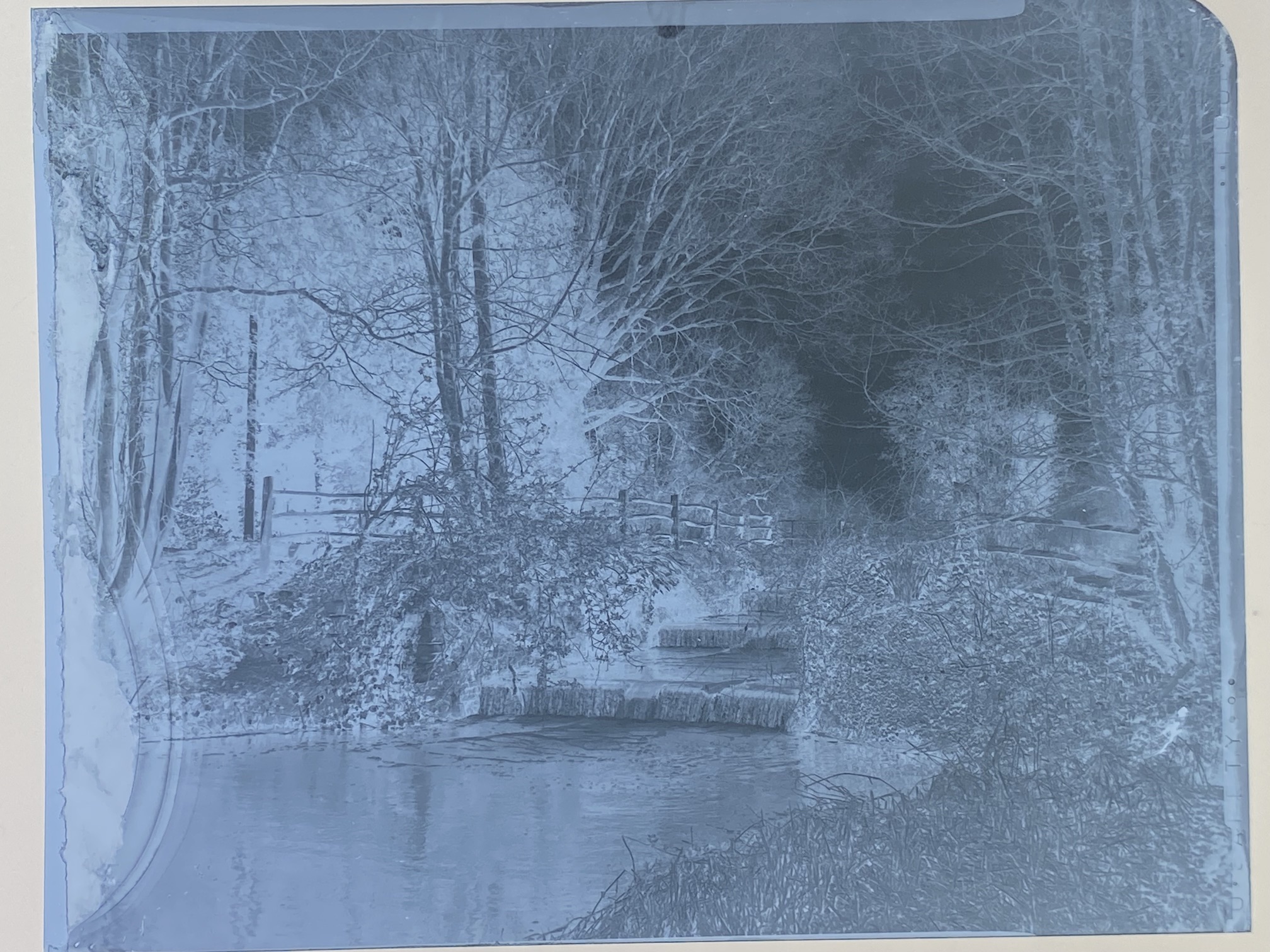

Ok, got a print done yesterday. Came out pretty much as expected. Had to reduce the UV exposure by one stop from my usual prepared negatives, mostly Pyro developed film or a digitial series I did last year. I hate the phone pic representations, it's pretty close but would say contrast is higher than actual print. The negative was pictured on a light box no adjustments made.
This is very helpful! Thanks for doing the test and sharing your results. Are you also using Recipe #143?
