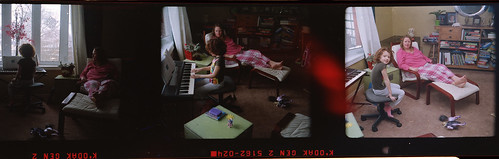

So my 100' roll of June 2010 expired Kodak Gen 2 (supposedly Pro version of Portra 160NC) arrived today. I loaded a roll in a used Solaris cartridge in the dark bag, got fed up with trying to punch holes so I just black electrical taped the cartridge together and tried it. It wouldn't advance with the finger on my junker Instamatic 500 so I snipped the finger off. Two advance/firings is slightly farther than needed but one gives overlapped frames. Still it is fairly easy to do the two firings. I could go less than two full advances but there doesn't seem to be much point when I have 100' to use up (and there are lots more 100' rolls where this came from). I shot with a flash f/5.6 1/60th and already souped it in my old 1L Tetenal kit, drying now...
I'm pleased as the "Kodak Gen 2" markings are only on one edge! I swear this film is meant for 126. Taping from the end of the roll puts the markings on the unused portion of the frame so I get a full 28x28mm frame picture. Great stuff!
I'll be able to load the unperforated B&W when it arrives from Europe too, which should be fun indeed. I haven't had B&W film for this camera since the early '80s.
Okay guys, for you aficionados, here's a cherry 126 SLR, yes SLR with removable lenses Ricoh 126c TLR. Local to me. I thought about buying it but it really deserves to be in the hands of someone who will shoot it. http://slo.craigslist.org/pho/2212623439.html Dirt cheap too! Only $20. I bet if you email them straight away and promise fast payment they might ship it. Just guessing though.
Kodak Gen 2:
Kodak Gen 2 Unperforated 35mm film by Harry Pulley, on Flickr
100' bulk reel, only markings on one edge, unperforated, perfect for 126 reloads! Developed with Tetenal Press Kit 1L, already over capacity but still working well.
The Kodak Instamatic 500 gives 32x30mm images on this film, actually more area than 135 format (36x24mm). With the Schneider Kruzenach Xenar 38mm f/2.8 lens (made in Germany) the pictures are quite good.
For the available light shots here I should have used f/2.8 but the bright window fooled me and the old Gossen Selenium light meter (and the film cartridge originally had 200 speed film in it so the body is metering 1/3 stop under, and the film is a bit expired). As you can can see in the third shot with flash the exposure is fine. The darker shots actually scan OK but look a bit too thin for traditional printing.
I snipped the sprocket hole sensing 'finger' off since punching holes was near impossible. This means I need to take two shots per shot as one crank of the winder lever doesn't go far enough. I hold the camera against my sleeve for the extra shots. As you can see this seems to be a bit prone to light leaks however... if I had a proper lens cap it would work but it is a 32mm size, difficult to find today and since it is not an SLR I'd be worried about forgetting to take the cap off afterward.
Is a bit odd that it says "K'ODAK" though, makes me wonder if it is Kodak film at all but I don't really care, it works and the price was right!
